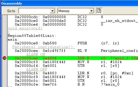

As far as IAR goes,
I have used it for AVR and this is how i saw the assembly file:
DEBUG or SIMULATE under PORJECT->OPTION->DEBUGGER  under SETUP tab, Select Driver to be SIMULATOR or your debugging tools.
Once simulation is in process, go VIEW-> DISASSEMBLY
Hope this helps.

Wouldn't going to Project -> Options, and selecting ''C/C++ Compiler'' and the ''List'' tab, and then checking the ''Output list file'' or ''Output assembler file'' options and sub options, do the job?

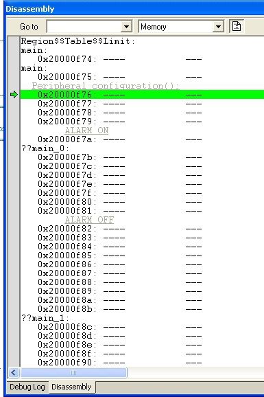

I do like you said me but that is the only i can see. I dont want this. I want code like:
What am I doing wrong?? I´ve checked Project/options/C-C++Compiler/List:
Output list file and Output Assembler file. One of each and both of them ways.

I know the reason. I was programming with STlink JTAG debugger and it must be done with SIMULATOR or altmost it works only in that way for me.
