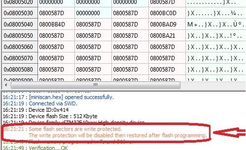

    Dear All,
    Please have a look. I have write protected area from 0x08000000 - 0x08004000 after  boot loader flashing. Now I flashes my application at 0x08005000(atarting address for my application, 0x080040000 - 0x08005000 (2KB)left blank intentionally ) using ST Link V2. Dont know why ST Link V2 removes the write protection (as shown in image below).
    So this has puzzled me how to make my bootloader fully write protected. Because in field application I don't want my bootloader section to edited/corrupted/updated by any means.
    Please guys give your ideas/ suggestions. Thank you so much in advance.
