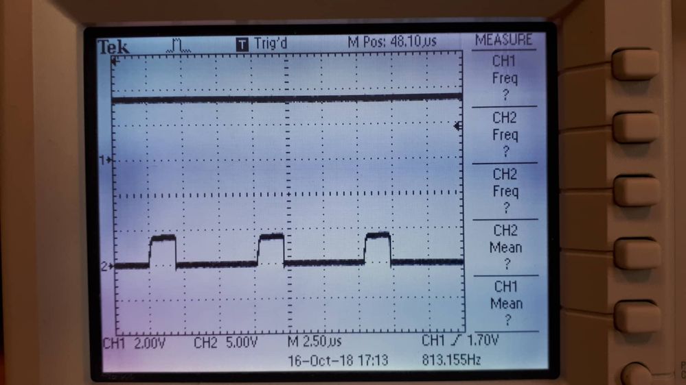

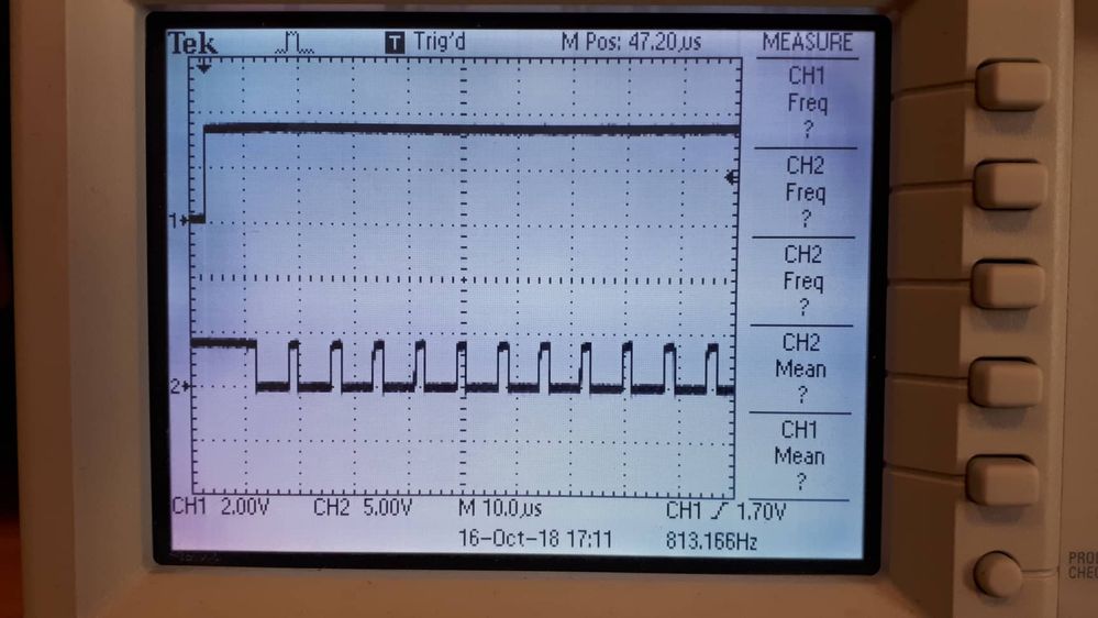

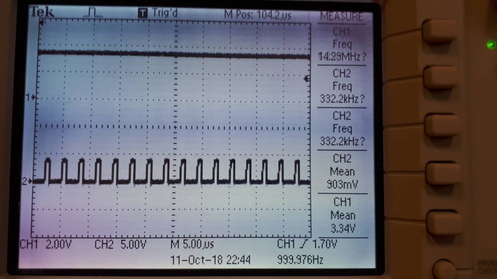

And here is my problem:
The whole proccess is really slow. It takes 0.5ms to send and receive all the data (15 bytes) via i2c.
The upper signal is generated by toggling the B7 pin at the start and the end of the interrupt routine.
The bottom one is the i2c SCL signal. This is what is looks like:

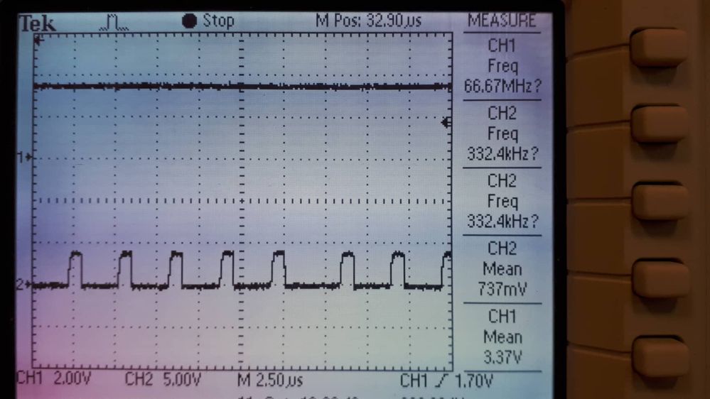

The signal is supposed to be 3x denser. It reminds me of this:
0690X000006CBe2QAG.jpgThis is visible on the measured frequency of the signal. It's 333 KHz instead of 1 MHz.
What could cause this? How did the data rate become so low and why does the SCL signal looks like this?

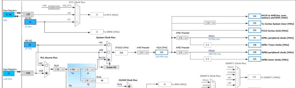

Or at least I think I do. These are my clock settings:
0690X000006C8lBQAS.jpgNow based on this I belive that my Timer3 (the one I use for the 1000 Hz interrupt) runs on 108 MHz.
So according to my understanding by using a prescaler of 1079 and a Counter Period of 99, the timer overload frequency'll become 1000 Hz.
In reality I get 1000 Hz if I use a Counter Period of 31. Based on this I belive my timer is not running on 108 MHz.
Also, no matter what prescaler and Counter Period value I use, I can't get a faster interrupt frequency thank a few KHz.
This might be a separate problem though.

Does the MPU6050 support I2C @ 1MHz? You really should be using SPI for these kinds of data rates.
AvaTar
Lead
I suppose it would be obvious if it doesn't. This would be easy to check.
> I've used the HAL libraries in both cases.
But perhaps this is the problem.
while(HAL_I2C_Master_Transmit(Handle, (uint16_t)address, &reg, 1, 1000) != HAL_OK);
In don't use Cube, but that sound a bit like busy-looping.
BTW, the editor in this all-new forum is a PITA.
MPU6050 doesn't support 1MHz I2C communication. 400KHz is what you can get at most. Try to change the I2C speed in Cube and regenerate the code, see what happens. Even at 400KHz you can do 1KHz easily. Or even twice as much.
It doesn't really matter for your current problem, but..
Your approach of doing the work in an interrupt handler is.. not very correct. Just mark some volatile flag and on appearance of that flag in your main loop start the i2c sequence.
If this is not just a demo then you can also use interrupts for i2c instead of polling. It just boggles me a little bit that an 216MHz monster is wasting time in polling when it could do so much work in that time, or just sleep if there is nothing to do.

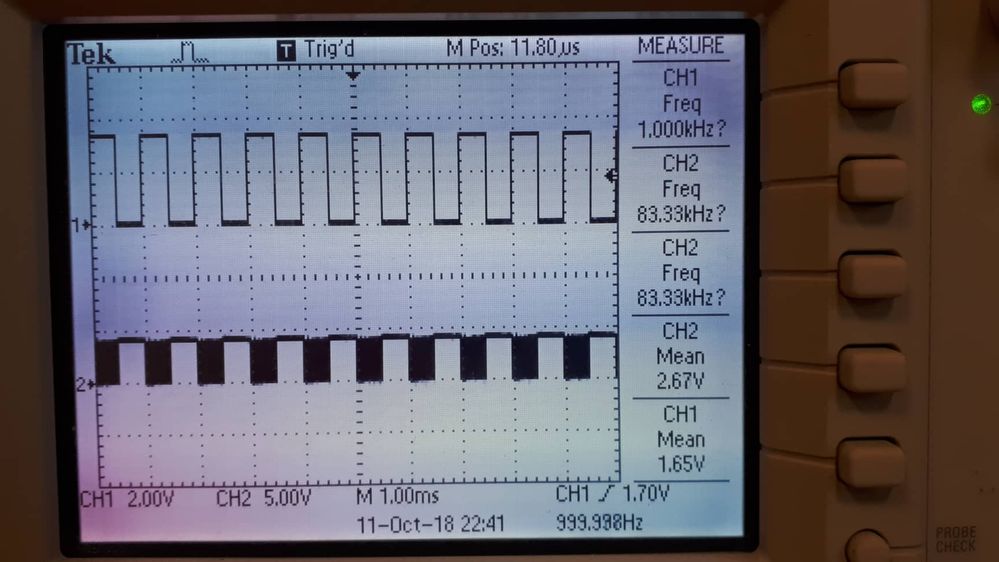

Here are the results with the recommended 400 KHz SCL settings:
As seen above, the execution of the interrupt takes longer than 1ms.0690X000006CC2nQAG.jpg
One cycle takes about 2.5 μs, so if everything worked fine then the frequency would be 1/2.5μs=400KHz.
But on the picture one cycle takes about 3*2.5μs because of the 5μs gaps, so again we get an actual SCL frequency 3 times slower than the expected.
In short, the problem is exactly the same with lower frequencies. My I2C clock has big gaps and because of this it's 3 times slower than the set SCL frequency value.
