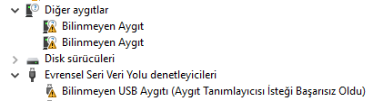

_legacyfs_online_stmicro_images_0693W0000000ASYQA2.pngDevice manager says unknown usb device (device identifier operation failed). On 5 V pin I measured 4.78 V and 3V pin 2.99 V.

If COM is neither red nor green and your chip has power, then likely your onboard ST-Link chip is fried. The actual MCU might be fine.

Assuming that's the problem, the ST-Link chip is dead.
You can still connect to the MCU chip if you have another ST-Link available. You need the NRST, SWDIO and SWCLK lines connected.
Probably easier to buy a new board though.
