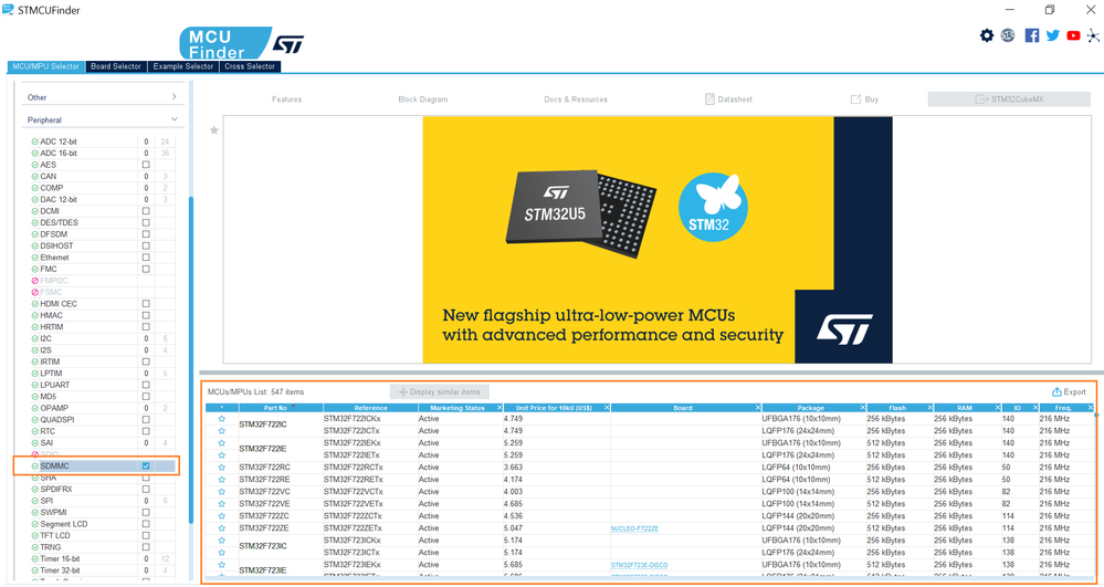

I am looking for STM32 microcontroller with SDMMC interface, but I can't seem to find one. There are no filtering options in the product selector. Is this something that I have to implement myself using GPIO?

Hi @SPate.4​ ,
If I well understand your request, you're looking for an STM32 MCU supporting the SDMMC interface. Please correct me if I misunderstood.
In case I correctly guess your request, I can propose you to download and install ST-MCU-FINDER.
This application integrates an the MCU Selector feature which enables filtering on a combination of criteria such as series, lines, packages, peripherals, etc.:
You can check the SDMMC and all the list of MCUs/MPUs supporting this peripheral will be displayed.
Hope this answers your question.
Khouloud.
‎2021-03-26 11:27 AM
The MCUfinder-PC or STM32CubeIDE currently list 547 different devices of STM32 with one ore more SDMMC channels.
The filter can be found in the Peripherals section, just give it a try. :grinning_face:
Good luck!
/Peter
