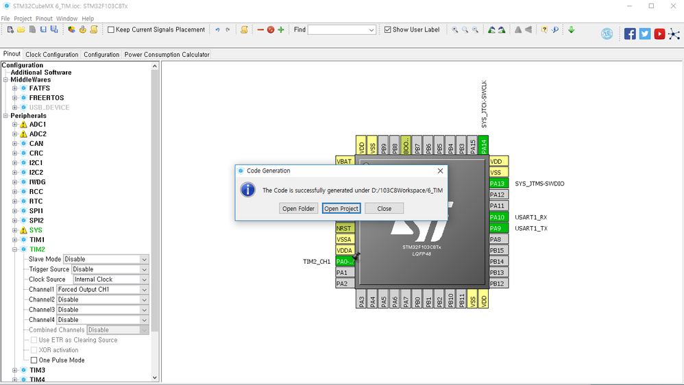

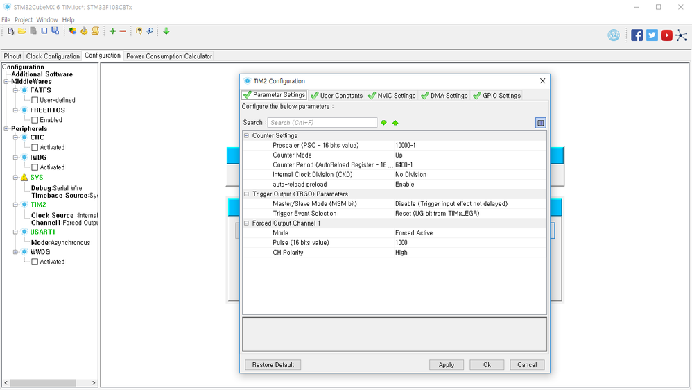

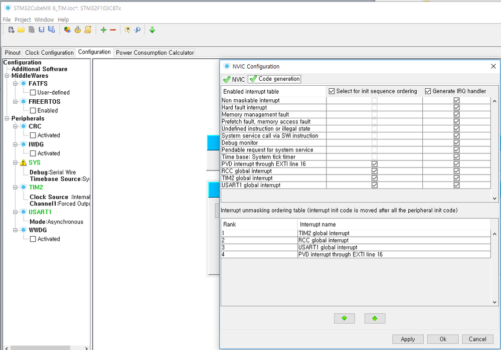

How to use "TIM2_CH1" Timer interrupt to make toggle LED at PA0 every 1sec
kdong.6
-I verify PA0 LED is good work(test with "HAL_GPIO_Toogglepin()")
-contains cubeMX project files, Truestudio projets
-my addtional user code down below
-cubeMX select option is also captured
==============usercode==============
 /* USER CODE BEGIN 2 */
 HAL_TIM_Base_Start_IT(&htim2);
 /* USER CODE END 2 */
 /* USER CODE BEGIN 3 */
 HAL_Delay(1000);
 /* USER CODE END 3 */
/* USER CODE BEGIN 4 */
void HAL_TIM_IC_CaptureCallback(TIM_HandleTypeDef *htim)
   HAL_GPIO_TogglePin(GPIOA,GPIO_PIN_0);
 HAL_GPIO_TogglePin(GPIOA,GPIO_PIN_1);
 HAL_GPIO_TogglePin(GPIOA,GPIO_PIN_2);
/* USER CODE END 4 */

Any other plans for TIM2?
Realistically time span stuff you'd use the Update interrupt and set the prescaler and period to divide down the source clock. Looks like you have an STM32F1 running at 64 MHz
So either prescaler=64000-1, period = 1000-1, or the other way round
For a 72 MHz clock, prescaler=36000-1, period=2000-1

As PA0 connects to TIM2_CH1_ETR one presumably could do this entirely without interrupts, and program CH1 into output compare toggle mode, and let the TIM flip the pin automatically.
waclawek.jan
Read out and check the relevant TIM registers, including whether interrupt is enabled in DIER. Check, whether interrupt is enabled in NVIC and in disassembly check whether the respective interrupt service handler (ISR) address is present in the proper place in interrupt table.
