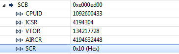

SEV instruction doesn't work for me. I don't know why? Could you give more details about configuring interrupt ? Thank you.
I configured the two event interrupt on CM4 and CM7 into NVIC1 and NVIC2:
In the two interrupt linked to the event I did a led toggle, as an example:

Using Timer4 on CM4 and Timer1 on CM7, I generate the SEV event:
void HAL_TIM_PeriodElapsedCallback(TIM_HandleTypeDef *htim)
	HAL_GPIO_TogglePin(LED1_GPIO_Port, LED1_Pin);
	__SEV();
	HAL_GPIO_TogglePin(LED3_GPIO_Port, LED3_Pin);
	__SEV();
And that's it: the LED4 and LED1 blink at the same time, so LED2 and LED3 do.
Make sure the 5th bit of SCR register is high: if I'm not wrong, according to the ARM manual, this bit means the CPU accepts the event via SEV.
I attatch the project, hoping it could be helpfull. It's developed with:
