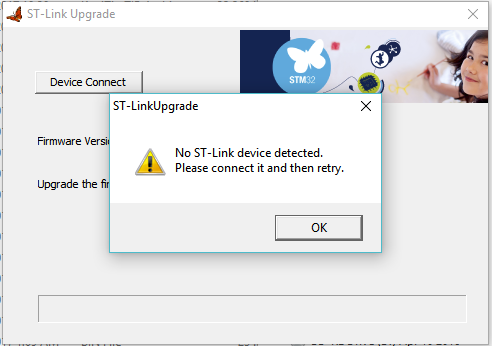

Windows has stopped this device because it has reported problems. (Code 43)  A request for the USB device descriptor failed. How to Fix Code 43 Errors for STM32F407G-DISC1 MCU?
NOTE: MY BOARD IS
STM32F407G-DISC1
I HAVE ALSO THE NUCLEO-F446RE AND WORKS FINE, AND NO ISSUE.
HOWEVER NEW BOARD IS
STM32F407G-DISC1 NOT FUNCTION AS INTENDED. THERE IS RED POWER LIGHT BUT NO LED LIGHT!
REGARDS
NEIL

Posted on November 10, 2017 at 21:29
Not really much in the way of IT support to be had here.
You should perhaps try a different cable, port, or computer (different Windows version). If it connects through a hub try direct connection.
Confirm if the board is functional on any. If it is visible a firmware upgrade to the ST-LINK firmware is recommended for the F407 and F429 DISC1 boards.
