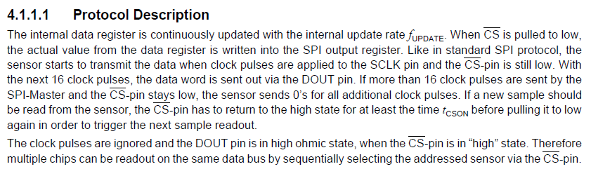

I'm using this current sensor: TLI4970-D050T4 According to the datasheet:
How can the SPI master send exactly 16 clock pulses to the slave? I'm using L432KC Nucleo running at 2 MHz, but the SPI clock has been prescaled to 1 MHz. I would appreciate any advice. This is the code that I use to read the sensor and calculate current:

// clear CS
uint16_t RxSPI = *((__IO uint16_t *)&hspi1.Instance->DR); // force 16bit transfer
// wait for last bit to leave pin
// set CS
otherwise, did you try to set the buffer to 16 bit ?
does this look ok guys ?
uint16_t SPIRx[64];
HAL_SPI_Receive(&hspi1, (uint16_t *)&SPIRx, 2, 10);
