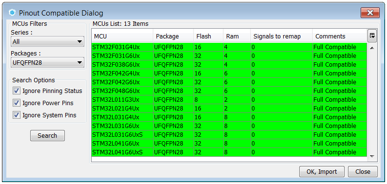

I m searching for a STM32L011G4 (16kb) compatible PIN to PIN mcu with memory>16kb. Is it exits ?

What pin-count/form-factor is the STM32L011G4 ?

Regarding your request: you can use STM32CubeMX:
- create a project with your device (STM32L011G4)
- go to pinout tab > List pinout compatible MCUs
==> you will get the list of compatible MCUs with details about the package, flash size and Ram size.
