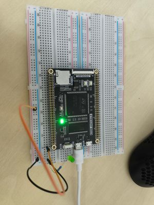

I just bought stm32 and i cant find any guides how can i enable led. I flashed pin PB7 so that it would output current

You need to connect the LED so toggling the pin completes the circuit.
Any of these:
[PB7] --> [LED] --> [RESISTOR] --> [GND]
[PB7] --> [RESISTOR] --> [LED] --> [GND]
[VCC] --> [LED] --> [RESISTOR] --> [PB7]
[VCC] --> [RESISTOR] --> [LED] --> [PB7]
Make sure the LED polarity is correct and resistor is sized such that the LED gets around 3 mA, or whatever the data sheet says is safe.
