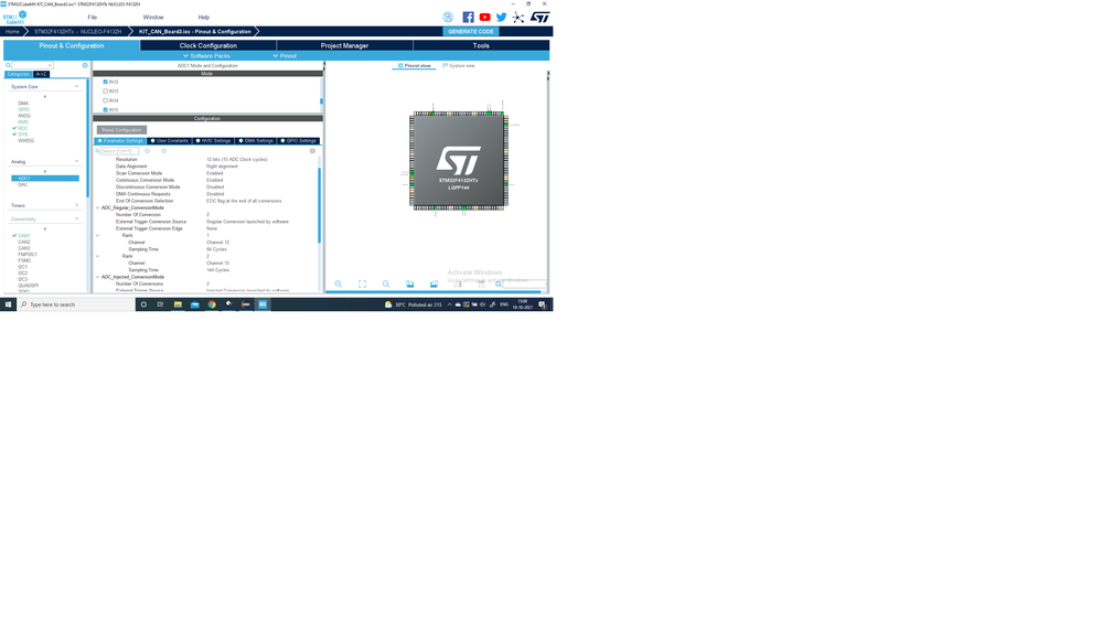

How to configure Two channel ADC Technique in STM32F413ZH Controller ?
RJANA.2
If I vary any one channel Input through POT, it is reflecting in another ADC Channel also... can anyone help me regarding this ?

ADC_ChannelConfTypeDef sConfig = {0};
/** Configure for the selected ADC regular channel its corresponding rank in the sequencer and its sample time. */
sConfig.Channel = ADC_CHANNEL_12;
HAL_ADC_Start(&hadc1);
HAL_ADC_PollForConversion(&hadc1, 10);
Pressure = HAL_ADC_GetValue(&hadc1);
HAL_ADC_Stop(&hadc1);
Code for reference @Georgy Moshkin​
Image is also attached below

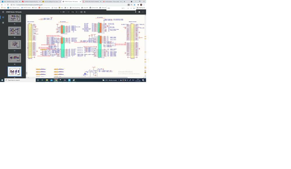

As far as i know this should not happen on ADC inputs. What board do you use? Some boards have erroneous markings, ensure it is correct pin. Probably ADC is configured wrong, or something else is connected to this pin on PCB, or you used wrong pin.
Check my STM32 Bootloader - flash your STM32 with AES-encrypted binaries right from web browser!
This controller pins selection is little bit confusing, Even I tried with all possibilities given in data sheet..
There are two pins for single channel ony, Even tried but no positive response
for more infor refer below image ; STM32F413ZH Tx Nucleo

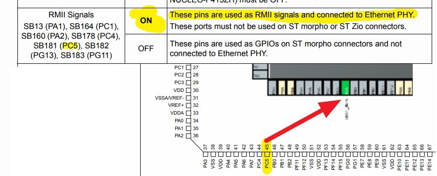

Please check UM1974 manual Table 12. Solder bridges:
0693W00000FD5KvQAL.jpgFrom your image it seems that you use following pins for ADC:
PC2 ADC123_IN12
PC5 ADC1_IN15 - this pin connected to ethernet PHY using solder bridge SB181.
Solder bridge must be removed if you want to use this pin as ADC input on PC5. Note other solder bridges too.
