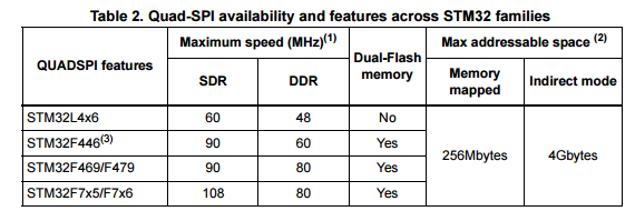

Hi all. I'm newbies for STM32F7xxx. How many Mb for NOR/NAND Flash can use with STM32F746ZG, Quad-SPI? Thank you.

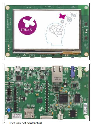

Hmm on the discovery the serial flash is fixed and sdio signals may not be accessible to plug other memories. For the chip itself, i guess that any size would work as the commands pass a 32 bit base address. Compared to usdcard qspi hw maps the serial memory within the stm32 memory space in read mode, enabling full hw management, xip and dma, dma2d access.
Posted on August 06, 2017 at 15:19
As I recall the decode window is 256MB (0x10000000). The limit on QSPI is no doubt in one of the manuals, and likely comes from either the address/command sequence used, or the address constraint just mentioned.
NAND only needs a few address lines, it behaves like a hard drive or mass storage device, so hundreds of GB, accessed via a window, and not providing execute-in-place.

You may find the answer to your question with more further details on how to use Q-SPI on
http://www.st.com/content/ccc/resource/technical/document/application_note/group0/b0/7e/46/a8/5e/c1/48/01/DM00227538/files/DM002275pdf/jcr:content/translations/en.DM002275pdf
