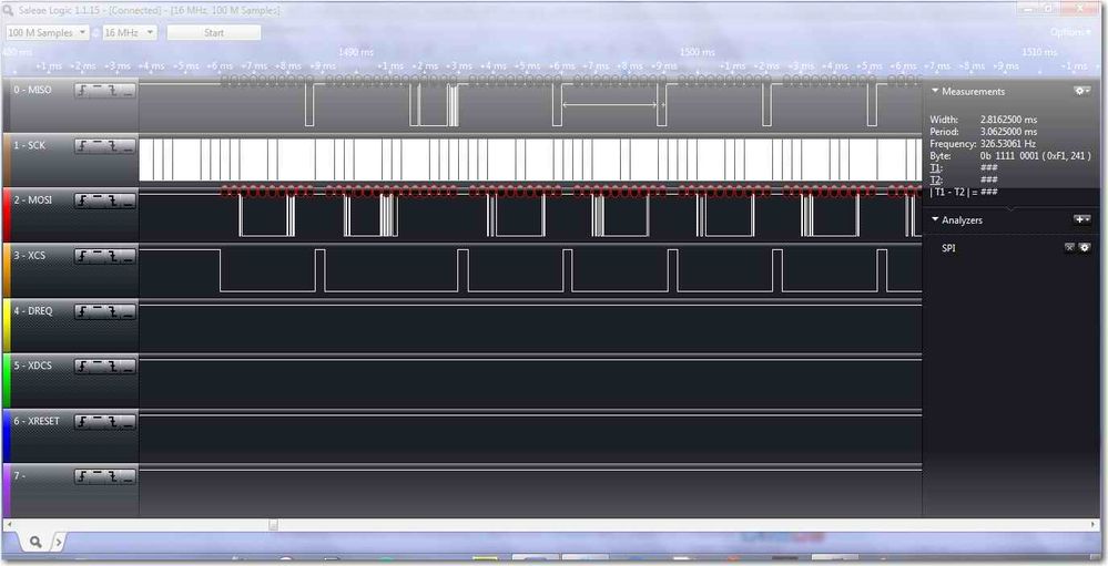

Can I bypass user_diskio.c and fatfs.c and put my init code in diskio.c ?
I don't what are those functions inside those files for, making the job more complicated...
Thanks
antonius
Senior
Posted on February 02, 2016 at 14:25
Please find the complete project attached, it's compiled with keil, thanks
