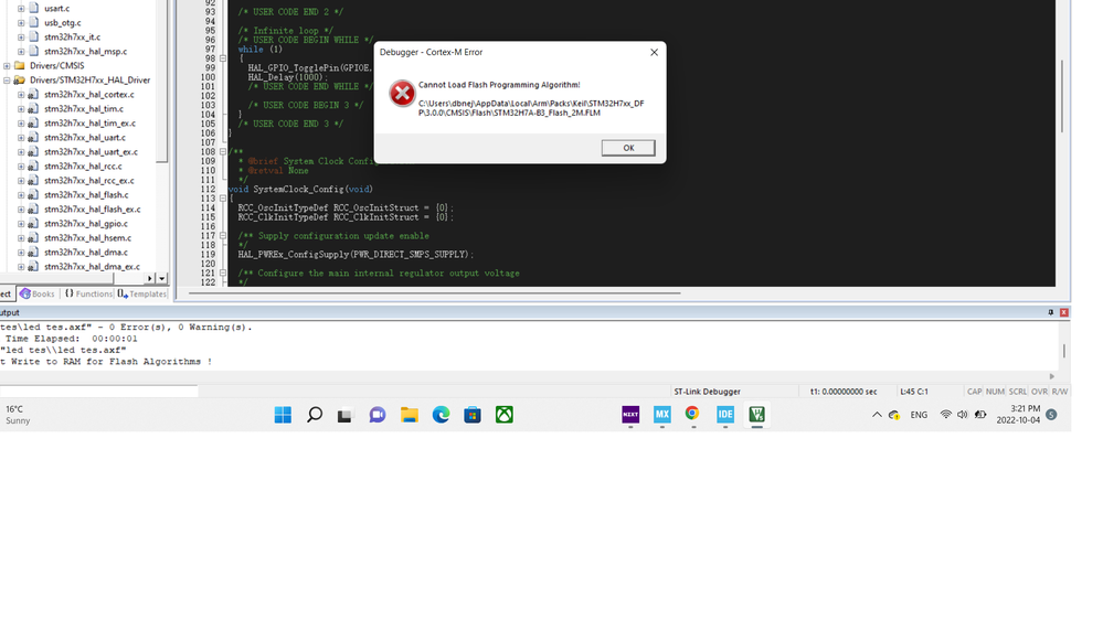

Thank you guys for your feedback. Yes, I am trying to program STM32 through its evaluation board which is "H7A3ZI-Q" by Keil. There is no error when I debug the code, but I get that error when I want to send it to the microcontroller.
DBara.5
0693W00000UnLPtQAN.pngI did fix the issue, but I get this error! I did try different "flash algorithms, but none of them did work!

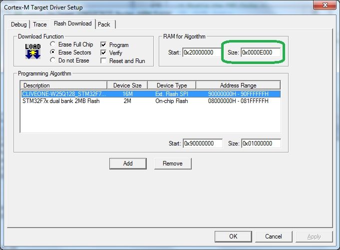

You probably need to expand the size of RAM allocated if the loader itself is large.

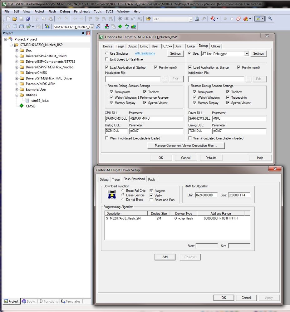

0693W00000UnLc9QAF.jpgOther than that the panes describing the Target settings might be helpful
You have a NUCLEO-H7A3ZI-Q board?
STM32Cube_FW_H7_V1.10.0\Projects\NUCLEO-H7A3ZI-Q\Examples\BSP\MDK-ARM\Project.uvoptx
RAM settings for Flash Algorithms
0x20000000 0xFFF4
FLASH
0x08000000 0x200000
STM32H7A-B3_Flash_2M
<Name>UL2CM3(-S0 -C0 -P0 -FD20000000 -FCFFF4 -FN1 -FF0STM32H7A-B3_Flash_2M -FS08000000 -FL0200000 -FP0($$Device:STM32H7A3ZITxQ$CMSIS\Flash\STM32H7A-B3_Flash_2M.FLM))</Name>
