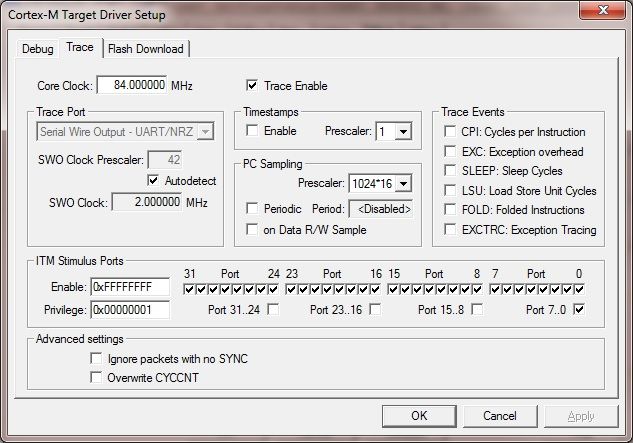

Ok, thank you! Now doesn't hang but doesn't print anything... :'(
 I've configured the Trace too.
What I do wrong?
Posted on August 08, 2016 at 17:47

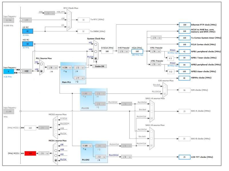

Are you sure the F429 is actually running at 168 MHz, and not something like 180 MHz? The setting of the clock is critical. Check the PLL setting in system_stm32f4xx.c and on the pins, ie MCO PA8
You should try doing a printf() early in main() to confirm you have connectivity.
For an 84 MHz system I'd set trace like this

Posted on August 09, 2016 at 13:08
Hi Clive1,
I've compute the value and obtain 168MHz. The clock is configurated as:
void SystemClock_Config(void)
RCC_OscInitTypeDef RCC_OscInitStruct;
RCC_ClkInitTypeDef RCC_ClkInitStruct;
RCC_PeriphCLKInitTypeDef PeriphClkInitStruct;
__HAL_RCC_PWR_CLK_ENABLE();
__HAL_PWR_VOLTAGESCALING_CONFIG(PWR_REGULATOR_VOLTAGE_SCALE1);
RCC_OscInitStruct.OscillatorType = RCC_OSCILLATORTYPE_HSE;
RCC_OscInitStruct.HSEState = RCC_HSE_ON;
RCC_OscInitStruct.PLL.PLLSource = RCC_PLLSOURCE_HSE;
RCC_OscInitStruct.PLL.PLLM = 8;
RCC_OscInitStruct.PLL.PLLN = 336;
RCC_OscInitStruct.PLL.PLLP = RCC_PLLP_DIV2;
RCC_OscInitStruct.PLL.PLLQ = 7;
HAL_RCC_OscConfig(&RCC_OscInitStruct);
RCC_ClkInitStruct.APB1CLKDivider = RCC_HCLK_DIV4;
RCC_ClkInitStruct.APB2CLKDivider = RCC_HCLK_DIV2;
HAL_RCC_ClockConfig(&RCC_ClkInitStruct, FLASH_LATENCY_5);
// Clock de LCD
PeriphClkInitStruct.PeriphClockSelection = RCC_PERIPHCLK_LTDC;
PeriphClkInitStruct.PLLSAI.PLLSAIN = 100;
PeriphClkInitStruct.PLLSAI.PLLSAIR = 2;
PeriphClkInitStruct.PLLSAIDivR = RCC_PLLSAIDIVR_2;
HAL_RCCEx_PeriphCLKConfig(&PeriphClkInitStruct);
HAL_RCC_MCOConfig(RCC_MCO1, RCC_MCO1SOURCE_PLLCLK, RCC_MCODIV_1);
HAL_SYSTICK_Config(HAL_RCC_GetHCLKFreq()/1000);
HAL_SYSTICK_CLKSourceConfig(SYSTICK_CLKSOURCE_HCLK);
/* SysTick_IRQn interrupt configuration */
HAL_NVIC_SetPriority(SysTick_IRQn, 15, 0);
By other hand, I add the MCO because there is not activated before (it's the first time that I work with MCO) I don't know if I have to configurate other things. I recreate the STMCube project in order to check what is the code to add, so I think it's enough. Also I want to share with you (and the readers) my Clock tree configuration, maybe it can help to detect the problem: 0690X00000603B2QAI.jpg I just check MCO1 pin and the result is 168MHz. This is correct, isn't it? But I can't achive view any printf :'(
Posted on August 09, 2016 at 15:15

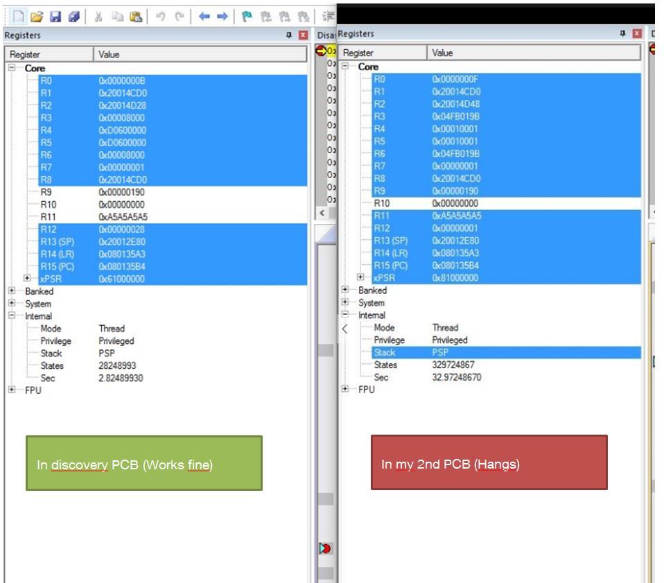

By other hand, I program into STM32F429I-DISCOVERY board and either I can't see printf (but the code runs correctly!).
I don't understand why in DISCOVERY board the code run perfectly and in my 2nd, 3th, 4th, board not (''my first'' board it runs ok, but it was programed by my old colleague). Is it possible that is there anything that it is necessary programed first, like a bootloader in order to it  works? because the both boards with the code runs contains a microcontrollers which not virgin.

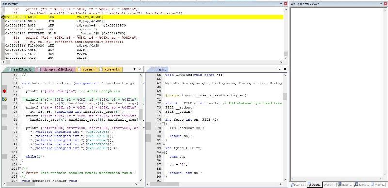

Posted on August 11, 2016 at 15:45
Hi Clive,
I've achived view the last instruction before the code hangs thanks to this application note
https://www.segger.com/downloads/appnotes/AN00016_AnalyzingHardFaultsOnCortexM.pdf
But in that point, I don't know interpret what these values mean. Can you help me?
Thanks
Posted on August 11, 2016 at 18:03
I'm not able to make any determination from that information.
If the Discovery board always works, and yours doesn't start looking very carefully at the hardware, especially the power, VCAP voltages, and understand where the designs diverge.
Look at the code at, and immediately before, the fault.
