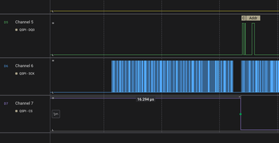

  1. Clocks are being sent pre-chip select
    There are a series of clocks being sent before the chip select goes low.  I have a free-running clock off; why am I seeing extra clocks?

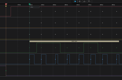

  2. The first clock pulse is sometimes missing:
    Every instruction/command is 0x32.
    However, some commands seem to be missing the first clock, and shifting this command to 0x64
    Correct Instruction Bytes – first clock is at 12ns, CMD is 0x32
    Incorrect Instruction Byte – first clock is at 20ns, CMD is 0x64

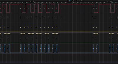

  3. Delays in the data stream when sending 640 bytes using DMA.
    The data stream has random pauses in the stream when sending 640 bytes @ 100 Mhz.  Perhaps the bus cannot keep up at this speed?
I am using DMA and enabled burst length of 64
