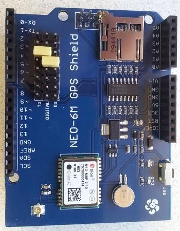

Posted on August 17, 2016 at 17:37
This how we do GPS on NUCLEO/DISCO here...
