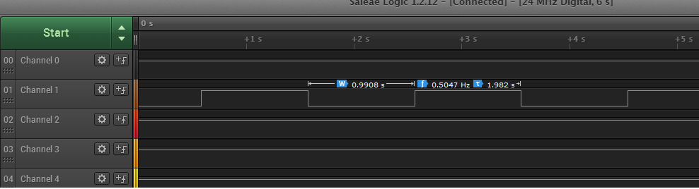

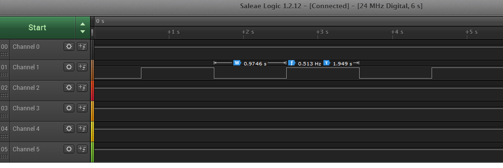

Hello ,
I am toggling a gpio inside the timer ISR . the timer ISR triggers for every 1 sec.
Actually i am not able to see perfect 1 sec of gpio toggling . it also differs at different AHB frequency . i have included 2 cases with snapshot. please help me understand why i can not get perfect 1 sec gpio toggling and why it is different at 2 different ahb frequencies .
In the ISR i am just doing GPIOC->ODR ^= 0x2000U;
case 1 : AHB = 16Mhz HSI, Prescaler of timer = 999, period = 15999  ( in the image there is a difference of 10ms)
case 2 : AHB= 50Mhz, Timer clock = 50Mhz, Prescaler of timer = 999, period = 49999 ( in the image there is a difference of 25ms)
In both case it is showing different output .

A few things have effect on the crystal, Like temperature and supply voltage.
For example in the STM32L083CZ datasheet on page 87:
MSI oscillator frequency drift   0 °C ≤ TA ≤ 85 °C -  ±3
A temperature between 0 and 85 degrees could cause a frequency drift of plus minus 3%
Same happens with the supply voltage.
Dont know why with different settings you get a different timing..

Hard to replicate from screen shots. Define which STM32, and show code.
Using HSE clock source?
Can you try with a calibrated scope?
Can you output internal clocks (HSI, HSE, PLL, etc) via MCO pin PA8, and scope those?

i am using stm32f446re nucleo board . , not using HSE. ,
i am using saleae logic usb logic analyzer . i dont have a calibrated scope.
HSI is 16Mhz verified using MCO. on MCO pin i can measure precisely ,

i can verify toggle mode . but before that i just want to know what exactly stopping in the code to get 1 sec precise gpio toggling. Do you mean HSI and PLLCLK is affecting this ? this may get better if i use HSE ? The first output is with HSI and second one using PLLCLK.
Posted on May 18, 2018 at 17:54
I would only expect a micro-second or less of latency, and jitter, of an interrupt based pin toggle from the TIM.
If the values are being measured wrong you have a couple of potential things going on, either the STM32 side time bases are wrong, or the equipment being used to measure is wrong, or has course granularity (based on sample buffer size and interval).
I'd start with a properly calibrated scope, or frequency counter.
Posted on May 18, 2018 at 23:27
what exactly stopping in the code to get 1 sec precise gpio toggling.'
you generally don't get that much timing error when interrupts are used.

6.2.2 HSI clock
Calibration
RC oscillator frequencies can vary from one chip to another due to manufacturing process variations, this is why each device is factory calibrated by ST for 1% accuracy at TA= 25 °C.
Yor are getting results close to the factory specification.
Have you calibrated the HSI better than 1%?
Using HSE from ST-link on nucleo boards has always be much better than HSI in my experience (12-15 boards).
