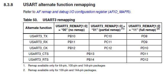

Normally USART4 if you program the GPIO as AF
To get USART3 to move there use
GPIO_PartialRemap_USART3
or
GPIO_FullRemap_USART3 A Partial Remap would move RX, TX A Full Remap would move RX, TX, CTS, RTS, CK

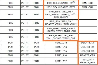

Posted on May 17, 2011 at 14:26 Thks for the quick reply. 1.- But how can i distinguish to this different columns that I?ve marked with red square? 2.- If i do GPIO_PinRemapConfigGPIO the pins gets multiplexed so then I can configure them?

1) The left box is the NORMAL mapping of USART3, the right box is a FULL REMAP of USART3. Look at the titles of the columns in the manual.
2) You will have to set the GPIO's attached to the peripheral (ie AF / Alternate Function - not a GPIO) for the outputs. And floating for inputs.

Posted on May 17, 2011 at 14:26 Thks for the reply. What document is that? I´ve the datasheet and the user manual and I havent this table.
Options
‎2011-05-17 5:26 AM
RM0008 Reference manual rev 11
http://www.st.com/stonline/products/literature/rm/13902.pdf
