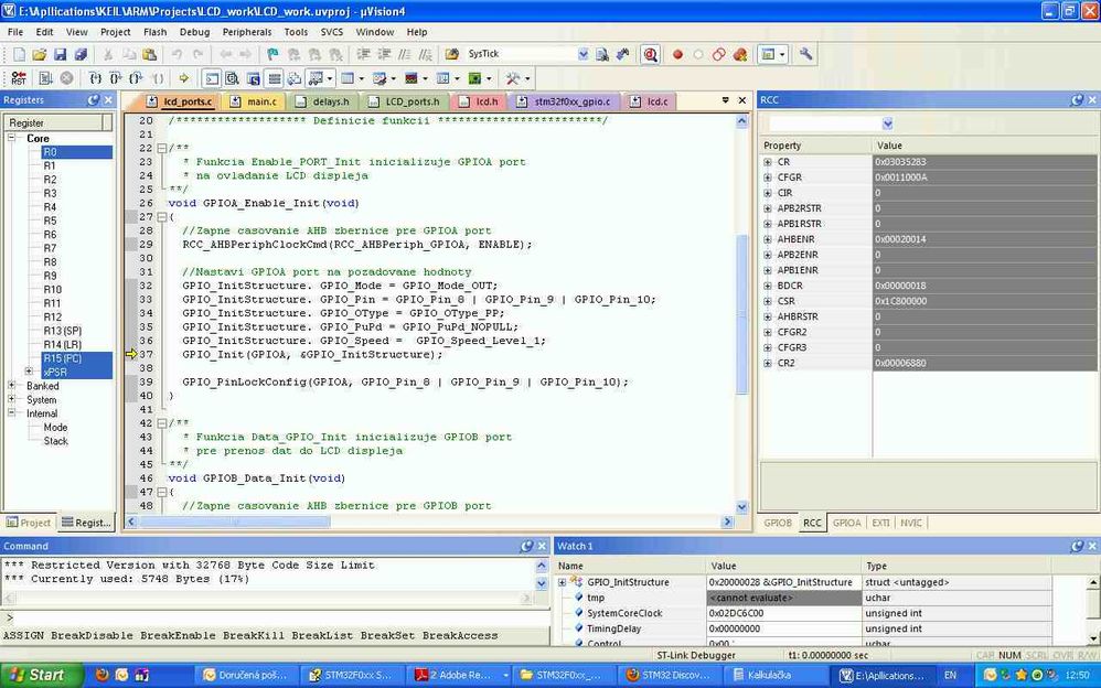

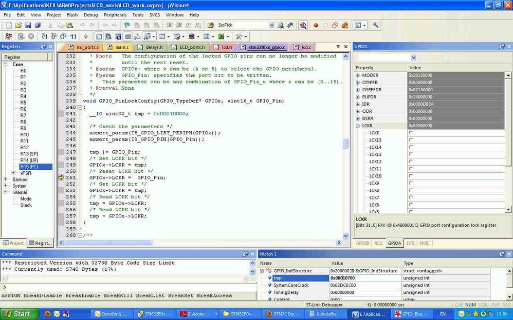

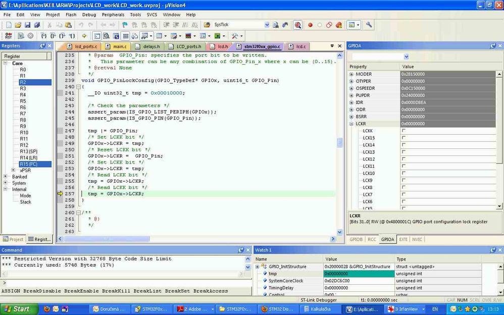

0690X00000603FSQAY.jpg below is screenshot of LCKR register in system viewer windows from uVision studio by passing through GPIO_PinLockConfig function. As you can see tmp variable is correctly set, but LCKR is not changed when I pass function 0690X00000603FXQAY.jpg and last screenshot after passing function where you can see that LCKR is written to tmp variable and its value is zero. LCKR is not set. 0690X00000603FcQAI.jpg Thank for your help. Martin. From: clive1 Posted: Monday, October 29, 2012 2:59 PM Subject: GPIO_PinLockConfig() does not work
