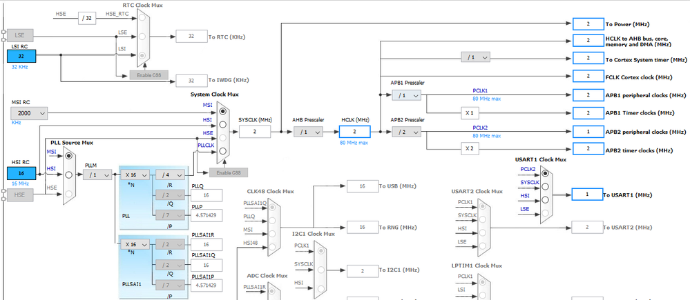

I'm using TIM1 and TIM2 of the L432KC. In the clock tree, I see APB1/APB2 peripheral and timer clocks bus frequencies. I thought that when I set a prescaler, the APBx timer clock frequency is the one divided by the prescaler, but actually is the APBx peripheral clock frequency. What's the real difference?

xpp07
Senior
Hi @Khouloud GARSI​ .
About question 1, I was confused because in CubeMx Clock Tree I see APBx Peripheral Clocks and APBx Timer Clocks, so I thought that Timers were clocked at APBx Timer Clocks, but actually they are clocked at APBx Peripheral Clocks.
About Questionn 3, I took the information from AN2581 App Note, but I realized that Timer 2 there is 16 bits, so it's okay.

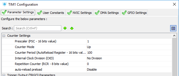

xpp07
Senior
@Khouloud GARSI​
Attached are my clock tree and timer setting for PWM 10 kHz on Timer 1 Channel 1. As you can see my prescaler is 1, so it's taking the 1 MHz instead of 2 MHz from APBx Timer Clocks.
Khouloud GARSI
Hi @XP.1acheco​ ,
In your case the APB2 timer clocks is equal to 2MHz.
Below is the equation that we use to calculate the frequency:
PWM Frequency = [Timer Fresuency ] / [(Prescaler+1)*(Period+1)] ; Since your Prescaler is one, the frequency will be divided by two (prescaler+1).
In order to have your expected frequency you should set the timer prescaler to 0.
Khouloud.
xpp07
Senior
Hi @Khouloud GARSI​ ,
Thanks for your patience.
If I want 10 kHz, then applying the formula with prescaler one and counter period 99 I have:
PWM Frequency = [2 MHz] / [(1+1)*(99+1)] = 10 kHz
Why do you say my prescaler should be 0?
Let me see if I understood the concept: APBx timer clocks are specifically for timers, and APBx peripheral clocks are for the other peripherals, right?
