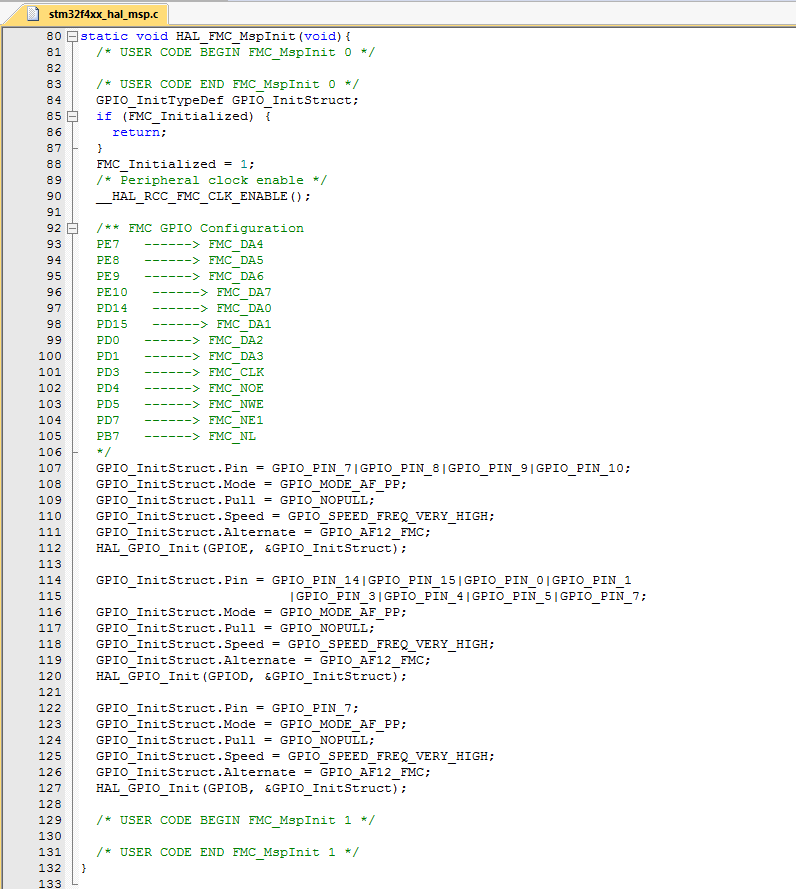

Imen.D
Posted on September 18, 2017 at 18:30
Hello
harry4516
Itested with the same board and CubeMX version (4.1):The
FMC clock is enabled and the
GPIOs are initialized in STM32F4xx_hal_msp.c file.
Please, try to share your ioc file to check your issue.
Kind Regards
Imen

Posted on September 18, 2017 at 22:26
Hello Imen,
thank you for answering.
How to reproduce the problem:
In CubeMX 4.22.1: New Project, select STM32F427VG, Start Project
Configure: FMC for LCD, A16, 16bit
Configure: RRC enable ext Clock
Generate program. This is all I have done.
If I look into STM32F4xx_hal_msp.c then I see no Clock or GPIO init, only Priority settings.
