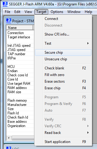

I secure the chip with jlink program menu:
0690X000006056cQAA.pngIn this state mcu operation has no problem and read from flash(eeprom emulation) is good.
but no success operation when I want to write data to flash and data is not saved.
What can I do? Is this way true?
Thanks.

''I secure the chip with jlink program menu:''
This is probably applying Sector Lock protection.
''but no success operation when I want to write data to flash and data is not saved.
What can I do? Is this way true?''
Having locked the Flash - you now cannot change the Flash unless it is unlocked first.
The Flash Lock just adds an additional step (sequence) in the programming sequence.

OK,I want read out protection and write to some page of flash at runtime.
So ''secure chip'' don't solve my problem at all.I want to use EEPROM_Write... and its not work on this mode,but I have another question: Is ''secure chip'' protect the code from read out?,because I cant read mcu in this mode with debugger or program it in uvision.
All of flash will be erased after ''Unsecure chip''.
Is there any way that I can use ''Read out protection'' and write in flash at runtime?
how can I enable read out protection(principled way)?
Thanks.

I found this function on flash peripheral library:
FLASH_ReadOutProtection();
This function change option byte and then,readout protection has been activated. There is no write protection flash page in this state,and work with eeprom emulation without any problem. There is a tip in ReadOutProtection: Mcu needs power on reset after set readout option byte. reset pin,or other reset solution don't reload option byte, only
power on reset
reload readout protection data. ''J-Link secure'' enable readout protection and flash write protection.We need only readout protection in eeprom emulation.So its not useful for this thread. Thanks for your answers. Problem Solved.
