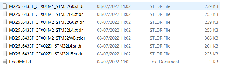

I'm using Nucleo-G474RE  + X-Nucleo-GFX01M2
I downloaded the X-Cube-DISPLAY package
I cannot find a flash loader file for the Nucleo-G474RE in the ExternalLoader folder. See below screenshot
Where to find an ExternalLoader file or can I use one of the below ones?
11 REPLIES 11
None of these are likely to work as they are board and architecture specific
I'll look to port the Macronix loaders to the G4 in the next several days as time/resources permit
