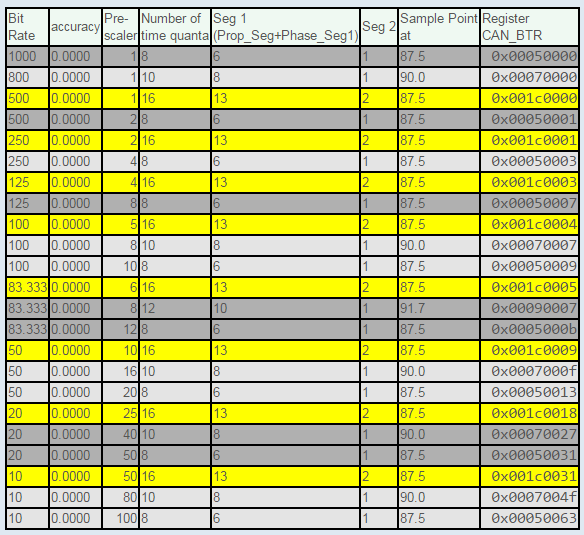

Szymon PANECKI
Senior III
Posted on October 19, 2017 at 13:57
Hello Alberto,
Thanks for your interest in STM32 MCUs and CAN interface. Obtaining CAN speed is a not an easy task, as you need to take into account many input parameters (clock feeding CAN peripheral, prescaler, time quantas) and CubeMX doesn't provide direct relationship between these parameters and CAN speed. For purpose of doing it in more automatic way I use this website:
http://www.bittiming.can-wiki.info/
 . Once you select CAN peripheral (STMicroelectronics bxCAN) and clock frequency (8MHz, 64MHz or other), you will get a table with different CAN speeds and parameters values related to these speeds. For example if I set slock frequency as 8MHz, I get such table:0690X00000608gYQAQ.png
I hope this information will be helpful to you.

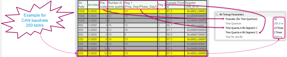

Posted on February 02, 2018 at 16:43
Please find below an example of translation between table and CubeMX.
0690X00000609a7QAA.pngI fully agree with you that it would be good if CubeMX would allow to fill in the CAN baudrate directly instead of forcing user to configure all parameters manually. Of course configuration of these parameters should be available, but in the first step they could be filled in by CubeMX based on CAN baudrate declared by user. I hope this feature will be available in one of future CubeMX releases.
