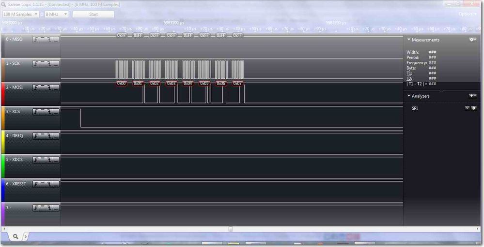

I can get DISK connected fatfs.c Line 48! On My serial but nothing in my Logic analyzer....where do I miss here ? I don't understand until this point....?? void MX_FATFS_Init(void)
{ /*## FatFS: Link the USER driver ###########################*/ //FATFS_LinkDriver(&USER_Driver, USER_Path); retUSER = FATFS_LinkDriver(&USER_Driver, USER_Path); //retUSER = FATFS_LinkDriver(&USER_Driver, 0); if (retUSER == 0) { HAL_UART_Transmit(&huart1, ''DISK connected fatfs.c Line 48!'', 31, 1); // Debug HAL_GPIO_WritePin(GPIOE, GPIO_PIN_6 , 0 ); HAL_Delay(1500); HAL_GPIO_WritePin(GPIOE, GPIO_PIN_6 , 1 ); } else { HAL_UART_Transmit(&huart1, ''DISK is not connected fatfs.c Line 48!'', 38, 1); // Debug HAL_GPIO_WritePin(GPIOE, GPIO_PIN_6 , 0 ); HAL_Delay(50); HAL_GPIO_WritePin(GPIOE, GPIO_PIN_6 , 1 ); } /* USER CODE BEGIN Init */ /* additional user code for init */ //testSD(); //USER_initialize(0); /* USER CODE END Init */ }- Mark as New

SPI2 test is working OK !
as I can see on logic analyzer Code :HAL_GPIO_WritePin(GPIOB, GPIO_PIN_10 , 1 );
HAL_Delay(100);
HAL_GPIO_WritePin(GPIOB, GPIO_PIN_10 , 0 );
uint8_t data1[8] = { 0x00,0x01,0x02,0x03,0x04,0x05,0x06,0x07 };
HAL_SPI_Transmit(&hspi2,data1,8,1000);
