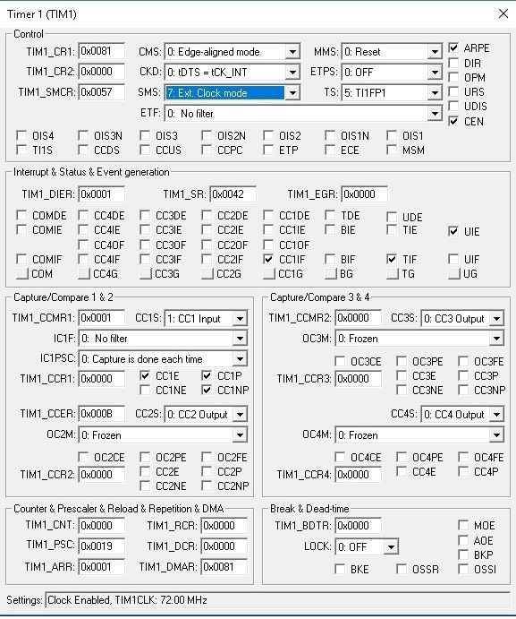

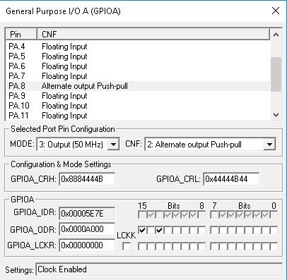

Hello I have to change my timer to timer 1 and this is my code
RCC_APB2PeriphClockCmd(RCC_APB2Periph_TIM1 ,ENABLE);
RCC_APB2PeriphClockCmd(RCC_APB2Periph_GPIOA|RCC_APB2Periph_AFIO, ENABLE); // GPIO_PinRemapConfig(GPIO_FullRemap_TIM3,ENABLE);GPIO_InitTypeDef GPIO_InitStructure;
GPIO_InitStructure.GPIO_Pin = GPIO_Pin_8; GPIO_InitStructure.GPIO_Mode=GPIO_Mode_AF_PP; GPIO_InitStructure.GPIO_Speed = GPIO_Speed_50MHz; GPIO_Init(GPIOA, &GPIO_InitStructure); TIM_TimeBaseInitTypeDef TIM_TimeBaseStructure; TIM_TimeBaseStructure.TIM_Period = 1; TIM_TimeBaseStructure.TIM_Prescaler = 25; TIM_TimeBaseStructure.TIM_ClockDivision = TIM_CKD_DIV1; TIM_TimeBaseStructure.TIM_CounterMode = TIM_CounterMode_Up; TIM_TimeBaseStructure.TIM_RepetitionCounter=0; TIM_TimeBaseInit(TIM1, &TIM_TimeBaseStructure); TIM_ARRPreloadConfig(TIM1,ENABLE); TIM_SelectInputTrigger(TIM1, TIM_TS_TI1FP1); TIM_TIxExternalClockConfig (TIM1, TIM_TS_TI1FP1, TIM_ICPolarity_BothEdge, 0) ; TIM_SelectSlaveMode(TIM1, TIM_SlaveMode_External1); TIM_ITConfig(TIM1, TIM_IT_Update, ENABLE); NVIC_InitTypeDef NVIC_InitStructure;/* Enable the TIM1 global Interrupt */
NVIC_InitStructure.NVIC_IRQChannel = TIM1_UP_IRQn; NVIC_InitStructure.NVIC_IRQChannelPreemptionPriority = 2;NVIC_InitStructure.NVIC_IRQChannelSubPriority = 0;
NVIC_InitStructure.NVIC_IRQChannelCmd = ENABLE; NVIC_Init(&NVIC_InitStructure); TIM_Cmd(TIM1,ENABLE);when i conncet pulse to pin a 8 the pulse change .
please help me.how can i fix it?

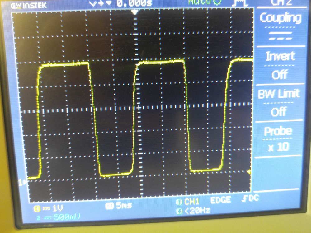

before connect to pin a 8

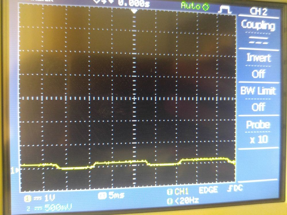

after connect to pin a 8
‎2017-10-22 8:44 AM
Consider using GPIO_Mode_IN_FLOATING for an INPUT
