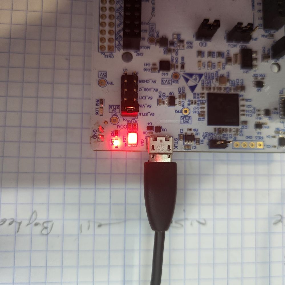

EVB NUCLEO-U575ZI-Q is not responding, when trying to run/debug. Besides that, LED6 and LED4 are red.
bmn
My EVB NUCLEO-U575ZI-Q is not responding.
When trying to run/debug, I get the following message:
Target no device found
Error in initializing ST-LINK device.
Reason: No device found on target.
How can it be fixed? Is the board ruined?
LD6 is on when U2 detects a fault and shuts down, i.e the board is drawing too much current (>500mA).
You may have a short-circuit somewhere.

Hi, thank you for the reply. I restarted my PC.
LED4 was yellow for a while and eventually returned to be red.
LED6 stayed red all the way.
