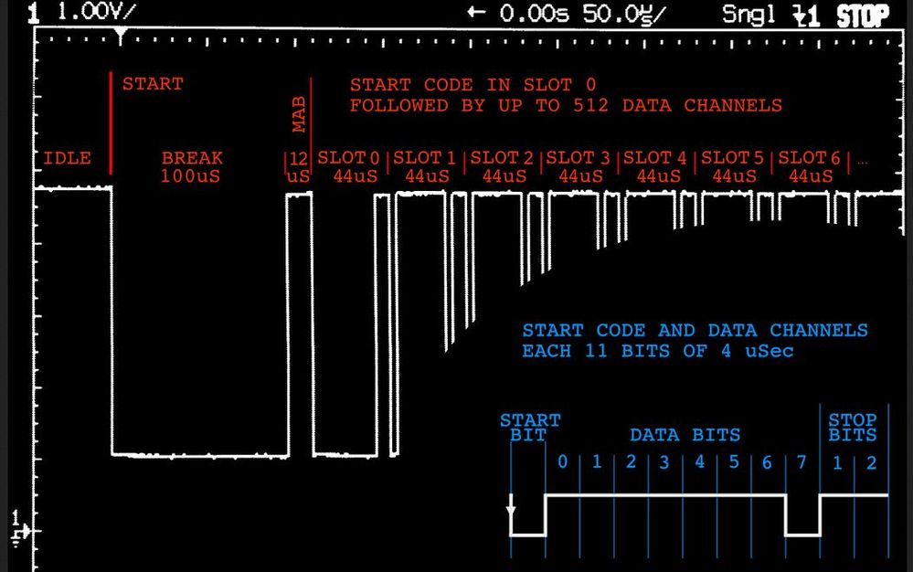

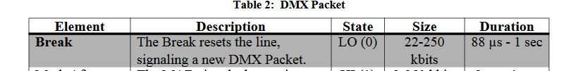

1-Break time is 44us but dmx need 92us at least how can solve this problem?

I took a look at dmx512 protocol.
It don't says ''send a break '' but describes Break condition as LO state of line. (means keep IO pin low for xxx microsec)
So i think you need a different approximation for your project..
For Break and MAB and MTBFs states you may use your TX pin as normal output and keep it low or hi for some time. .
When you need to transmit serial data Change it to Uart tx pin and transmit the data!

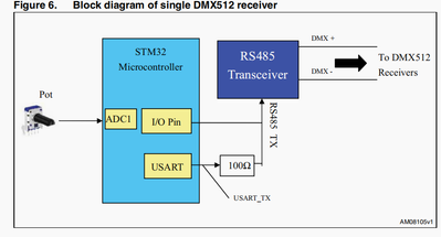

2024-06-26 11:58 PM
The USART module available on STM32
microcontrollers has the ability to automatically generate a 12-bit long break signal,
corresponding to 48 µsec at 250 k baud. Unfortunately, this is too short for use in a DMX512
application as the protocol requires a minimum length of 92 µsec.
Figure 6 shows the alternative hardware method chosen to generate the longer break
signal. A 100 Ω resistor is connected in series with the microcontroller's USART transmit pin
and the other end of the resistor to an I/O pin. With this solution, the break time can be
varied, from 92 µsec to 176 µsec to meet the DMX protocol break time specification, when
sending a break signal, the I/O pin is driven low. Later, the I/O pin is tri-stated to allow
transmission from the USART to resume.
