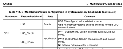

2024-08-19 6:24 AM
Yes, it supports USB DFU as noted in AN2606.
Do yourself a favor and use SWD during development and debugging.
