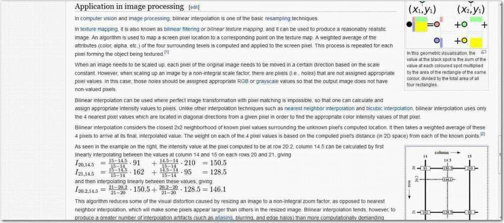

So if I follow :
http://upload.wikimedia.org/wikipedia/commons/thumb/a/a7/Bilin3.png/220px-Bilin3.png from http://en.wikipedia.org/wiki/Bilinear_interpolation#Application_in_image_processing I will shring the picture by half ? for example 1024 x 768 becoming 512 x 384 ?2014-04-20 10:28 PM

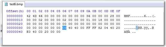

I have test6.bmp which is 2x2 pixel 24 bits:
2014-04-21 05:17 PM
Am I on the right calculation and way of thinking ?
thanks2014-04-21 05:30 PM
Does it always begin from offset 0x3E on the file no matter the resolution of the picture ?
It's the same for 1bit,8bits,16bits and 24bits picture ? I can see from every pictures, it's started from 0x36, reference :Start of pixel array (bitmap data)
36h 3
00 00 FF
0 0 255 Red, Pixel (0,1)
http://en.wikipedia.org/wiki/BMP_file_format#Bitmap_file_header

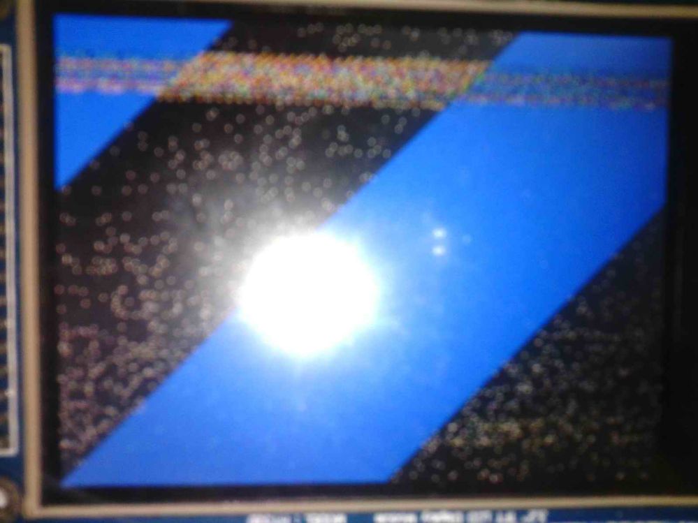

Thanks2014-04-26 09:36 PM
I tried this code :
//262K picture
uint16_t destx;
uint16_t desty;
delay_ms(1500);
LCD_Clear(Black);
res = f_open(&fsrc, filename, FA_READ);
f_read(&fsrc, hdr_256,
sizeof
(hdr_256),&bytesread);
// Read header
off = *((uint32_t *)&hdr_256[0x0A]);
// offset to rasters
sourcewidth = *((uint32_t *)&hdr_256[0x12]);
// X pixels
sourceheight = *((uint32_t *)&hdr_256[0x16]);
// Y pixels
f_lseek(&fsrc, off);
// Seek to the data
destx = 0;
desty = 0;
for
(y = 0, ny = 0; y < sourceheight; ny += 3, ny++)
if
(ny == 5)
y++;
ny = 0;
for
(x = 0,nx = 0; x < sourcewidth; x += 3,nx++)
uint32_t rgb;
if
(nx == 5)
x++;
nx = 0;
f_read(&fsrc, &rgb, 3, &bytesread);
// Read pixel B G R
// RRRRRRRRGGGGGGGGBBBBBBBB 8:8:8
// RRRRRGGGGGGBBBBB 5:6:5
rgb = ((rgb & 0xF80000) >> 8) | ((rgb & 0x00FC00) >> 5) | ((rgb & 0x0000F8) >> 3);
LCD_SetPoint(desty, destx, rgb);
destx++;
if
(destx == 320)
destx = 0;
desty++;
f_close(&fsrc);
delay_ms(2000);
for displaying :
http://iphotobucket.com/albums/p231/picture_77/test32_zpsa24eb6e1.png
but it's displaying :http://iphotobucket.com/albums/p231/picture_77/IMG_20140427_095513_zpsd8864b8e.jpg
Does anyone have a clue ? thanks2014-04-27 09:40 AM

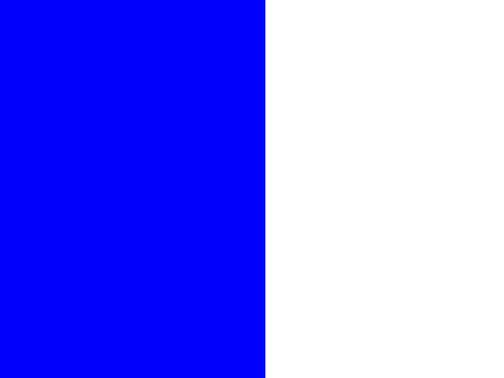

I want to convert 1024*768 :
The result I got from that function :http://iphotobucket.com/albums/p231/picture_77/IMG_20140427_095513_zpsd8864b8e.jpg
Do you have idea where I miss here ? thanks2014-04-28 04:06 AM

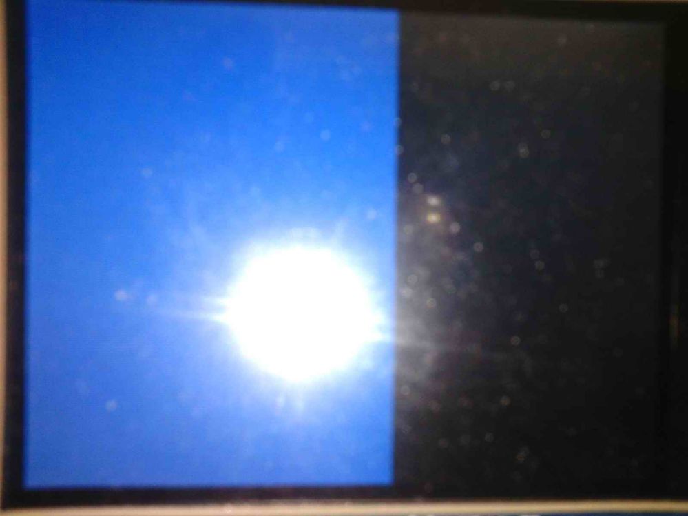

2014-04-28 05:38 AM
It does the task but why can't I see the white color ? suppose to be blue and white,
but on LCD blue and dot dot white not complete white ? Have a look...
