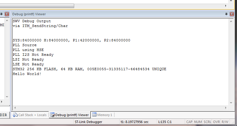

Posted on November 30, 2013 at 13:23
This is normally addressed by a project local copy of stm32f4xx_conf.h which is pulled in by stm32f4xx.h (USE_STDPERIPH_DRIVER) or stm32f401_discovery.h, and a local copy of system_stm32f4xx.c with the correct PLL settings.
See project  construction in STM32F401-Discovery_FW_V1.0.0\Projects\Peripheral_Examples\ADC_DMA
If the board is in fact running at 84 MHz, and the trace clock is set to this, the SWV output works. I'm in transit now otherwise I'd ZIP up the project to demonstrate.
If the clock is of concern output it via one of the MCO or TIM pins and physically confirm.

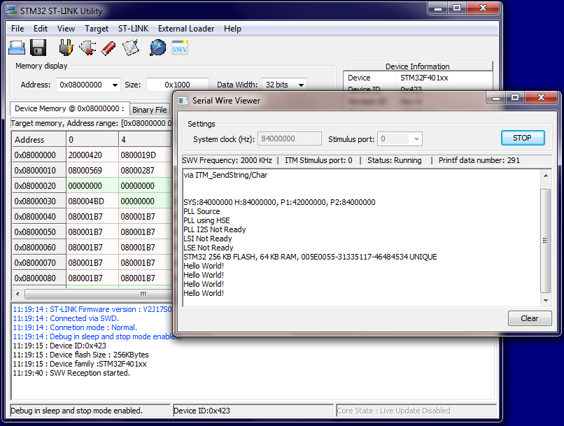

Posted on December 02, 2013 at 18:12
Building with 4.70 with library and project arranged thusly
C:\Keil\ARM\Examples\ST\STM32F401-Discovery_FW_V1.0.0\Projects\SWV-DEMO
https://drive.google.com/file/d/0B7OY5pub_GfITVdTbF9iX0dLSkE/edit?usp=sharing

Posted on December 03, 2013 at 14:28
The CPU/Xtal selection are not critical, the memory allocation is important to the linker, and the CPU type (Cortex-M4) to the compiler.
The Xtal on the Discovery board is 8 MHz. It is the clock setting in the Debug/Trace pane that is critical to SWV support.
The template project uses STM32F4_256KB, as of 4.71a there doesn't appear to be explicit support for F401 parts, they are nevertheless usable.
