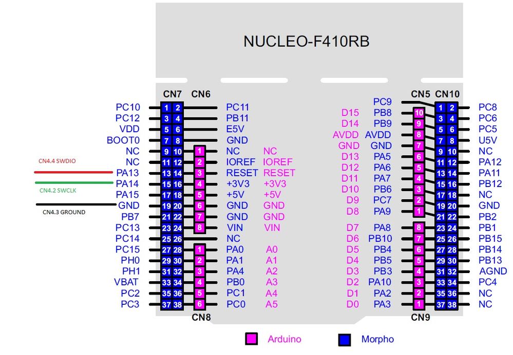

I am using both Nucleo-64 and Nucleo-144 boards in my project. On the Nucleo-64, the cutable PCB has been removed, and signals from CN6 on the cutoff board were tied to the Morpho connector as outlined in the docs. (NRST, SWCLK, SWDIO, and ground). The board is powered via the +5 inputs.
I get an error message indicating that the device cannot be programmed - 'Cannot Load Flash Programming Algorithm'.
The wiring has been double checked, so we think that's OK. Is the ground possibly screwing this up?
Any help would be appreciated.

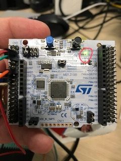

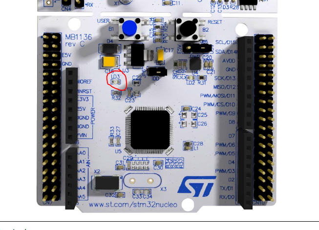

Posted on September 19, 2017 at 17:07
Hi again.
I  wrote about Nucleo 64   I have one of this in my hands.
LD3 at Nucleo64 is tied to 5v  just before 3.3v regulator.  It should be On.
PA14, PA13, GND and NRST pins are used to program the board.
Posted on September 19, 2017 at 17:20
Also writing about Nucleo-64. LD3 circled in red is on.Wires are connected to PA14, PA13, GND and NRST.

Posted on September 19, 2017 at 18:15
For the NUCLEO-64
CN4.2 PA14 CN7.15 SWCLK
CN4.3 GND
CN4.4 PA13 CN7.13 SWDIO
CN4.5 NRST CN7.14 RESET
