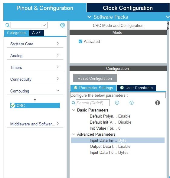

CRC_POLYLENGTH_16B undeclared in STM32F030CCTx
Soad
In `STM32F030CCTx` I need to set the CRC in 16-bit length by calling
HAL_CRCEx_Polynomial_Set(MATRIX_UART_settings->crc, CRC_POLY, CRC_POLYLENGTH_16B);
but the compiler shows the error :
'CRC_POLYLENGTH_16B' undeclared (first use in this function)
in the `stm32f0xx_hal_crc.h` file `CRC_POLYLENGTH_16B` is defined under preprocessor directive like
#if defined(CRC_POL_POL)

How can I access the `CRC_POLYLENGTH_16B`? and any documentation for using the HAL CRC library?
The STM32F030CC does not support the programmable polynomial modes, it just supports the default 32-bit method.
The RM defines how the hardware functions, the HAL here is a relatively thin abstraction.
For 16-bit CRC you're going to need to use software methods.
3 REPLIES 3
In your CubeMX project, activate CRC under the Computing tab. This will set the defines appropriately such that the crc headers are included.
Alternatively, modify stm32f0xx_hal_conf.h and uncomment #define HAL_CRC_MODULE_ENABLED. This will do the same thing provided you already have the appropriate HAL CRC files in your project.
Soad
In the CubeMX I have already activated the CRC スクリーンショット 2023-10-23 113347.jpg
and in stm21f0xx_hal_conf.h  file the  #define HAL_CRC_MODULE_ENABLED is already uncommented.
