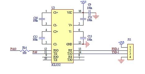

I had tried the previously posted USART1 code fragment on an STM32F103RET device (512KB), there wasn't any other initialization of hardware from the boot vector to the main() function. So I'm pretty sure it represents the minimal requirements to actually get the USART to function.
Are you sure the code is actually downloaded and running? Can you step it along with a JTAG debugger? In Keil you can actually view the peripheral and clock settings.
The USART1 output pin shouldn't be floating. As you have wires to the Rx pin PA.10 you could try setting it as a PP GPIO output and bang it up and down to see if that is working in the loop. You could try something similar on PA.9 too. Do you have any other pins connected to LEDs or other signs-of-life type indicators which you could toggle?
You could perhaps try the code on an eval/dev board with the pins already wired to an RS232 interface.
-Clive
Edit: Not sufficiently familiar with IAR, but you might want to check the RAM and STACK settings for the project, or code in the startup.s (or whatever) that takes the boot vector/initial stack pointer. If something is wrong there the CPU will Hard Fault. You could evaluate this by debugging with a JTAG probe and walking through the code as it executes.

I have a graphic routine that show life on an lcd. it runs before the USART init (your example) and it shows ok on the LCD. I even added an ICL3232 to amplify and stabilize PA9 - but I still see nothing on Pin14...0690X00000602hQQAQ.jpg
I can't believe that I can do anything on this board, load graphics, animation show pictures, read keys but I can't get the USART1 to work ...
It's a custom hand-held unit not the development board. it only had the STM chip, 8mhz crystal, LCD and a few buttons.
Maybe it's a faulty chip but I doubt it ... it's Friday so I'll keep at it a little longer since I'm not in the office tomorrow ...
I don't have JTAG I have an oscilloscope which I often use .. I can see life on many pins (meaning it's alive) but not on PA9, pin 68 of the STM
