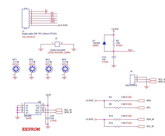

I need some help understanding a schematic of a cmos image sensor module we are going to purchase due time. The issue is that we have been testing out with a 8bit DCMI using a stm32f429 for previous modules but this doesn't seem to have the outlets for the data pins.
![0690X000006030hQAA.jpg 0690X000006030hQAA.jpg](/t5/image/serverpage/image-id/47646iB85CAA7F048F9F43/image-size/large?v=v2&px=999)
That's the sensor module and the related connections. I need to know whether the schematic shows a pin outlet for the PD[0:7] and the rest of the pins required for DCMI

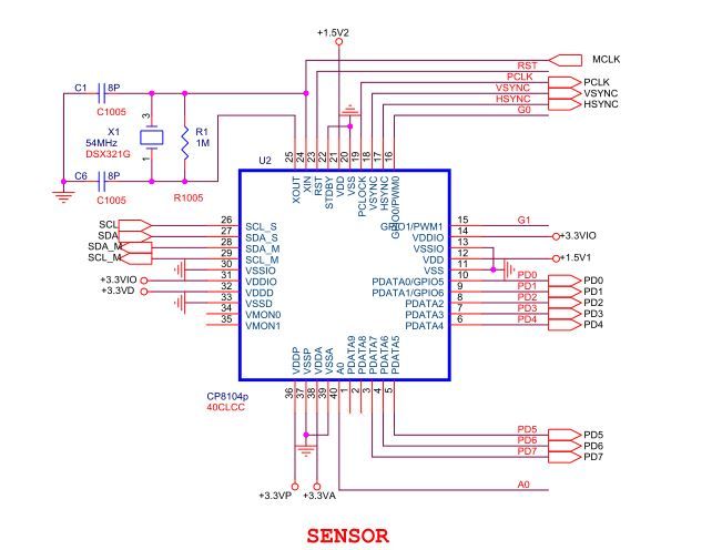

This is another portion of the schematic:
![0690X000006030mQAA.jpg 0690X000006030mQAA.jpg](/t5/image/serverpage/image-id/47653iBAC180883B793CD5/image-size/large?v=v2&px=999)
The confusion I have now is that i see that PD0 and PD1 have outputs but the rest don't seem to have an output to be connected to the external processor. Could you please just clarify this?
