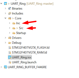

Hi Carmine,
Thanks for your post.
One question for you and I would be very glad if you could answer. I am using STM32F407VG-DISC1 board.
I have checked the repo you ve provided. I wonder that, is that OK if I copy ringbuffer.c under core-->src and also ringbuffer.h under core -->inc.
Then, can I use ringbuffer functions with ease ?
You're responding to a very old post, I think several forum transitions ago, the OP might not respond.
I'd imagine you can use C rule to determine how best to integrate this into your build. Ring / Circular buffers being a pretty basic concept.
Thanks for the heads up.
I have already raised a question here, but no one responded yet, meanwhile I was looking for a solution then I noticed this thread.
As it is pretty basic, could you please check my issue in above link and also please point me to the right direction ?
