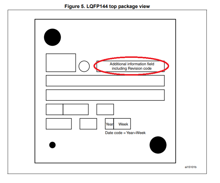

The value at the address 0xE004 2000 (DBGMCU_IDCODE) is 0x10006430 which means the revision id is 0x1000.  Per the RM008 Reference Manual the only valid value is 0x1003.  I'm looking in errata document to determine which I2C issues apply to the processor we are using (STM32F103ZG).  Is the document incorrect? Which revision are we using?

The flash memory size is ​1024 at 0x1FFFF7E0.  The printed information on the chip is
ZGH6
GQ 259 93 12
CHN GQ 751 A
Khouloud GARSI

Regarding the revision you're using, you may have it using STLink utility tool or it's marked on the chip.

I think this is a BGA package, the revision is marked after the year/week code, and it has already been clearly established what the part is reporting, which is consistent with that.
ZGH6
GQ 259 93 12
CHN GQ 751 A
