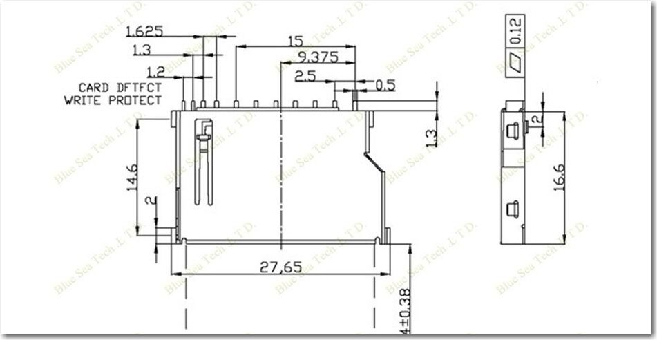

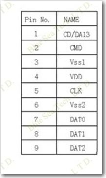

Guys,
Do I need to use Card detect ? (CD) because it's joined together on my connector...and in the code it's separated as two pins ?
Any ideas ?
thanks
7 REPLIES 7
Posted on April 10, 2014 at 15:33
Your diagram and legend do not correlate. The socket has 11 pins, the last two being physical switches, one for CD (Card Detect) and the other WP (Write Protect)
You should connect DAT3 to the SDIO D3 pin, it's ''CD'' function relates to a non-switched method where the card indicates it's presence.
