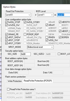

I have tried everything I can think of to get part to program, I still get this:
The elf loader Sector Erase function fails.
Memory-Loader error
Error occured during erase operation!
Programming error @ 0x08000000!
I have tried STL CLI, JFlash-lite, JFlash, STM32Cubeprogrammer, always the same thng.
If anyone has any ideas I would be grateful.
mark4444az
Found this:
  1. Make PCROP_RDP checked, enable RDP level 1
  2. Program option bytes.
  3. Disable RDP.
  4. MCU should be erased to 0xFFFFFFFF
That actually worked!  Found it on another thread.

Is it a custom board? If yes do you have checked SWD connection?
If you are able to etablish a SWD connection with STM32CubeProgrammer, check option byte if the device is not protected (RDP ?)
BR
Romain
mark4444az
I am using an STLink-V3Minie. I can look at the Option Bytes:
The Read/Write Protection is not checked so it is not on. Further, I have tried the JLinkSTM32 executable to reset options back to factory settings, said that  worked.

Yes, replaced the processor and programmed with gui and it's ok. The issue appears to be in my script file:
ST-LINK_CLI.exe -c SN=002000283431511737393330 -p RAD3.hex 0x08000000 -v -rst
When I use that it seems to brick the uP.
