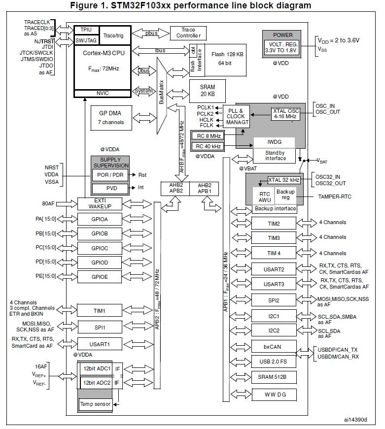

, but I wanted to know which resources uses the STM32 to communicate by CAN ?
According to my researches I think it’s the Cortex M3 processor, am I right ?

the different registers use for CAN communications are obviously stored onto the STM32 card, but where ?

They are in a big block of IP that represents the CAN Peripheral.
The Cortex-M3 is just the processor core, it is surrounded by very large peripherals composed of tens-of-thousands of logic gates (or equivalents). The F1 design has a block of RAM used by the USB and CAN peripherals.

This is the diagram from the Data Sheet, the CAN stuff lives inside the bxCAN block and the SRAM 512B block, lower right corner
