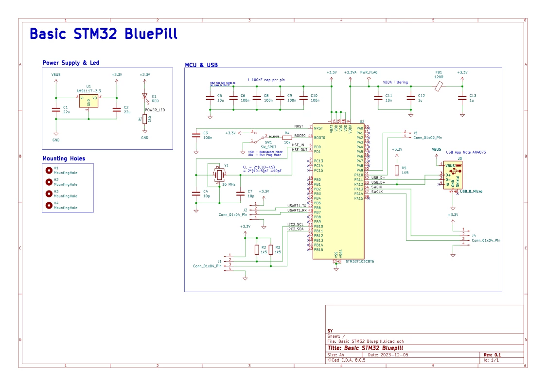

I found this schematic and layout with a stm32f103c8t6. I ordered it and wanted to programm it.
With stm32cubeprogrammer I detect the stm32 no problem via ST-LINK.
Same with stm32cubeide I can download successfully the code.
But now the problem is that eventhough the code is downloaded successfully the simple program to blink a pin to which I attach a diode is not working and I don’t see why.
I also want to be able to send data from my computer to the STM32 with USB but after downloading the code with "usb_device.h" and MX_USB_DEVICE_Init();, deconnecting ST-LINK and connecting with USB the STM32 is not recognized by the computer.
Any idea of what I could look for or ressources ?
If you see any problem in the design please tell me.
Regards,
Jean

Peter BENSCH
January 28, 2025
Blue Pill and other coloured ‘pills’ are not a product of STMicroelectronics and use counterfeit STM32F103, especially for the Blue Pill. STM32 tools can therefore not support this and reject a connection with it.
Solution: either ask the counterfeiters for help or get a NUCLEO, e.g. the NUCLEO-F103RB from an authorised dealer.
Hope that helps?
Good luck!
/Peter

JTAPIEAuthor
January 28, 2025
Hi, the manufacturer did the assembly so I don't know where they bought it but the MCU doesn't seem to be counterfeit. It has the logo ST on it.

Peter BENSCH
January 28, 2025
Unfortunately, our logo on an MCU does not prove at all that it is an original. STM32F103C8T6 in particular have been counterfeited on a large scale for several years, including the logo.
In cases where you cannot be completely sure that the seller is selling original goods (Aliexress, Ebay, etc.), it is advisable to check this with a test programme. You can also find tips on this here in the community, e.g. here or there.

Peter BENSCH
January 28, 2025
Which LED you want to flash?
I don't see any LED on PA9 that you are trying to control with your code?
JTAPIEAuthor
January 28, 2025
It is a LED connected to the pin A9 and to GND, i checked that the diode was working when connected to +3.3V to GND it is the case so the diode is not the problem.
Andrew Neil
January 28, 2025
No series resistor?
Andrew Neil
January 28, 2025
Please see How to insert source code - not as screenshots.
Please show how you are attaching the LED.
"Not working" tells us little: does the LED not light at all? stay on permanently? burst into flames?
@JTAPIE wrote:
Any idea of what I could look for or resources ?
Use the debugger to see what the code is actually doing.
Certainly, get the LED working before moving on to advanced stuff like USB!
JTAPIEAuthor
January 28, 2025

Andrew Neil
January 28, 2025
So have you used the debugger?
Andrew Neil
January 28, 2025
JTAPIEAuthor
January 28, 2025
No that's why I tried to do this new PCB.
