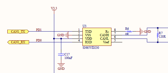

What do you think about the code. Are sure that code is true. Can you try or look this?And I use keil ide. Can I see that the data is send without using the oscilloscope.
I think the code has a high probability for functionality, but I can't afford the time/resources to work on your project.
When I tested and validated my CAN interface I used TWO units, one was in receive mode, the other transmit. You need something to sink/acknowledge the data, and the sense of the CANL/H pins is probably important. I used a 125 kbaud rate.
I have another F4 board using the same transceiver you are, the schematic for that is as follows

You can download my source code to the link. I make same schematic with you. Maybe source code have some problem. I use below link tranciever.
http://www.wvshare.com/product/SN65HVD230-CAN-Board.htm
Posted on May 16, 2014 at 21:34
Ok, this works for me on the
http://www.ebay.com/itm/RedDragon407-STM32F4-Cortex-M4-Ethernet-wireless-2-4G-SDIO-Serial-camera-/121087293812
http://propix.com.pl/pl/p/file/c607647297f9dda1e83738404a3c69b2/schemat_f4pdf
although I found that the CAN2 RX/TX were labelled/connected backward
// RedDragon 407 - CAN 125 Kbps RX and TX - sourcer32@gmail.com
// CAN1 PD0 (RX), PD1 (TX) J2, J3 ON
// CAN2 PB12 (RX), PB13 (TX) board miswired RX/TX switched
// J9-1 to J10-2, J9-2 to J10-1 fixes routing to SN65VD230
// CAN1_L to CAN2_L, CAN1_H to CAN2_H, GND already Common
// USART6 PG9 (RX), PG14 (TX) J13/J14 at 2-3

/* quanta 1+6+7 = 14, 14 * 24 = 336, 42000000 / 336 = 125000 */
/* CAN Baudrate = 125Kbps (CAN clocked at 42 MHz) Prescale = 24 */
/* Requires a clock with integer division into APB clock */
CAN_InitStructure.CAN_SJW = CAN_SJW_1tq; // 1+6+7 = 14, 1+14+6 = 21, 1+15+5 = 21
CAN_InitStructure.CAN_BS1 = CAN_BS1_6tq;
CAN_InitStructure.CAN_BS2 = CAN_BS2_7tq;
CAN_InitStructure.CAN_Prescaler = RCC_Clocks.PCLK1_Frequency / (14 * 125000); // quanta by baudrate
CAN_Init(CAN1, &CAN_InitStructure);
CAN_Init(CAN2, &CAN_InitStructure);

Thank you very very much my code is working now :)))
johnbroadbent.ky9
Posted on August 07, 2015 at 02:59
This is my first post.
I want to thank clive1 (the keymaker) for all his help. He is very helpful.
I am using the stm32f407 discovery board. The code below works, but the bus does not operate at the correct speeds.
But if the
CAN_Prescaler is set to 3 the messages work at the correct speed.
CAN_InitStructure.CAN_Prescaler = 3
Also (as stated else where) it is critical that a can transceiver to connected to can_Rx, and can_Tx pins, for the pins to send messages. The MCP2551 does work as transceiver, but the (AMIS-30663, and the sn65hvd230 are better choices imho).
Thank you all for your help, and nice support forum
