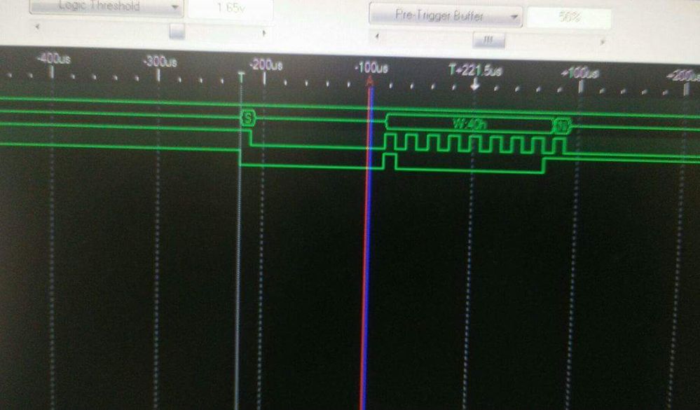

I am facing the same problem. i'm betting an ACK failure after sending the slave address. So I am not sure what the problem is. I have attached a screenshot of the data being transmitted when viewed on a logic analyzer. Please help.
