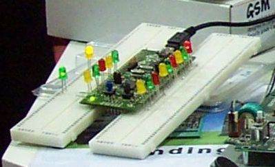

I'm not aware of such a thing, but you can mount it on standard breadboards like this:
Similarly with any other 0.1'' prototyping method...

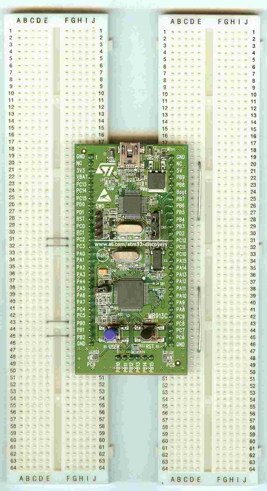

Or you could do it like this:

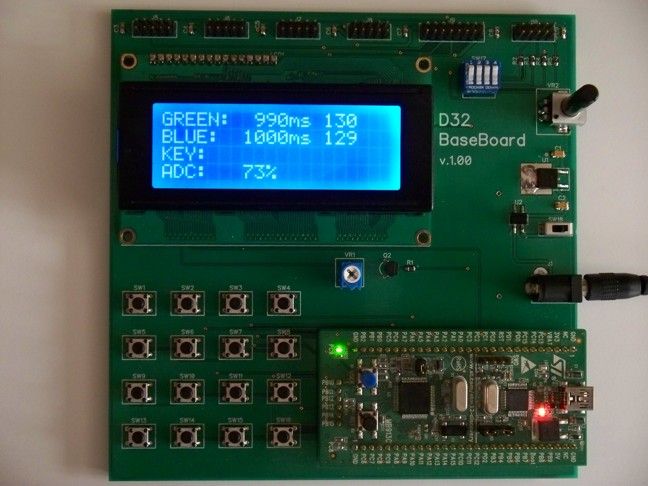

How about something like this?  I'm working on submitting it to kickstarter to get some built up after I tweak the design a bit.

Nice Idea. Pretty much impressed

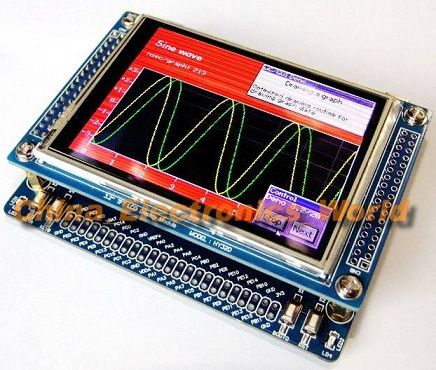

I use the ST-VLDiscovery purely as a debugger (and programmer with ST-LINK).  For development, I prefer one of these (about $45 shipped from the auction sites):
CPU:
STM32F103VCT6
, TQFP100;
FLASH: 256K BYTES, SRAM: 48K BYTES
4 X LED (one Power LED)
1 X USB to RS232 (USB to RS232 port)
1 X USB2.0 Device mode interface.
1 X Micro SD TF card socket.
1 X 3.2-inch TFT (with touch screen) interface, can be controlled via MCU, FSMC 16-bit interface mode.
1 X JTAG
4 X functional keys
1 x RTC with battery back-up battery holder(Battery is not included).
All GPIO port Lead out.
They are compact, can be easily powered by batteries (I use 3x AA NiMH) and have a useful variety of features. I also occasionally use the MCU on the ST-VLD to do processor-to-processor development using jumpers.

''1 X 3.2-inch TFT (with touch screen) interface''
Is that just the interface, or is the actual display module included (as shown in your picture)?

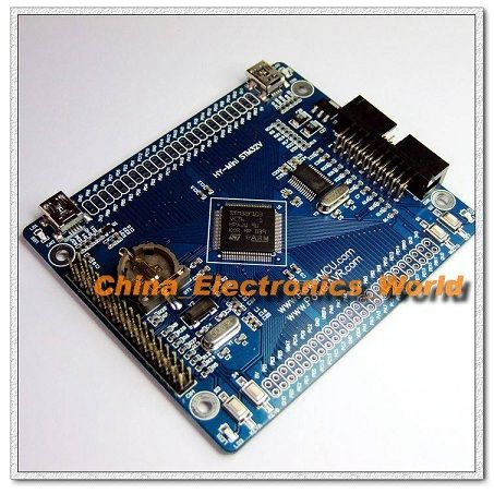

rmteo
Posted on October 30, 2011 at 17:46
Everything that you see in the picture (including the TFT LCD and touch panel) is included. Here is an image of the MCU board alone.
