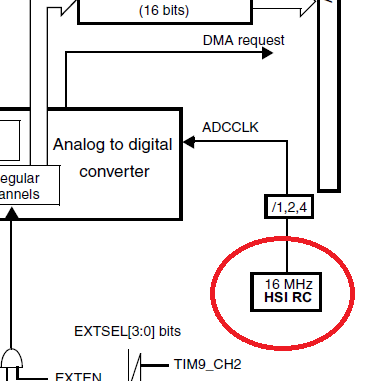

I am currently stuck on a problem where I believe I have acquired the proper examples and tried to follow form, but I cannot get a value out of my ADC. On my device there is only 1 ADC (ADC1 on APB2). Below is some code I run from IAR debugging with a ST-Link. One problem right off the bat is that 'result' is consistently ''unavailable'', except when I make it static, then its filled with some unchanging gibberish. I don't know the significance of channels, and I realize that may be the issue, but I tried to iterate through all of the available channels to see if I can get anything, and I seem to hang around channel 5, where I'm stuck on the End of Conversion flag check. Please help!

You should perhaps make sure that the HSI is enabled and running.

Hello Clive,
Thank you for the quick reply!
I made the following changes to ensure HSI is enabled:
  if(RCC_GetFlagStatus(RCC_FLAG_HSIRDY) == RESET){
      // Enable HSI Clock and wait until it's ready
      RCC_HSICmd(ENABLE);
      while(RCC_GetFlagStatus(RCC_FLAG_HSIRDY) == RESET);
still same old problems. Thank you for taking the time to help me out. I'm not sure what other information would be helpful to solve this problem, but I wonder if it has to do with calibration? I read on another forum that this may be done automatically though, so perhaps my problem is sampling rate, or something stupid like type mismatching. IAR still says that 'result' is unavailable, and never gets set, not even to 0.

Test this on an STM32L-Discovery, verified with PA1 attached to VDD and then GND and observed full scale measurements. Attempted to recreate your configuration using code from my own trees.

/* Enable The HSI (16Mhz) */
RCC_HSICmd(ENABLE);
/* Check that HSI oscillator is ready */
/* ADC1 Configuration ------------------------------------------------------*/
