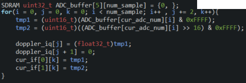

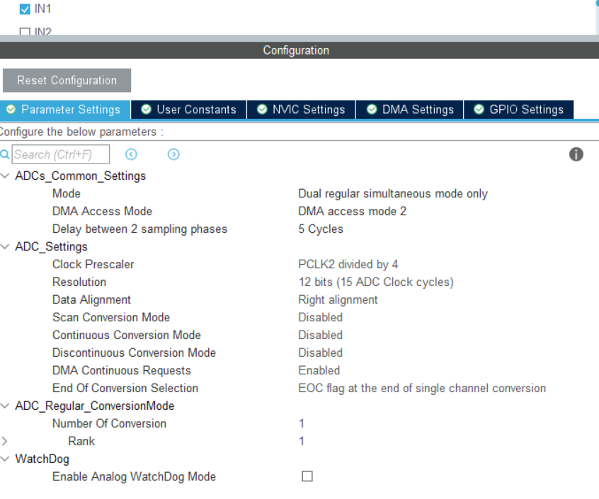

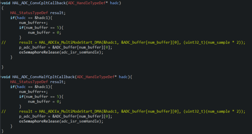

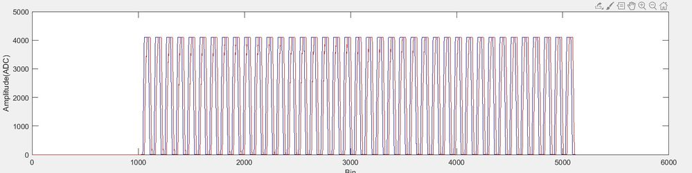

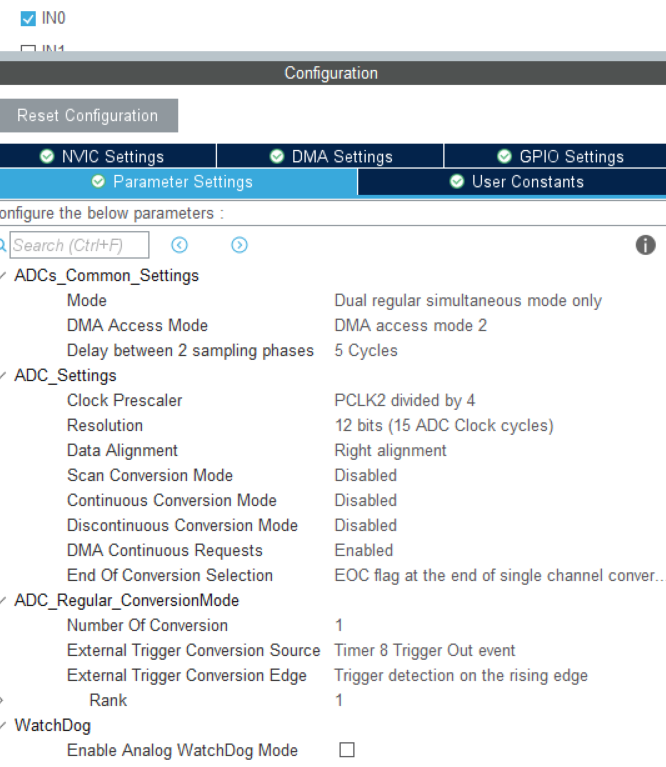

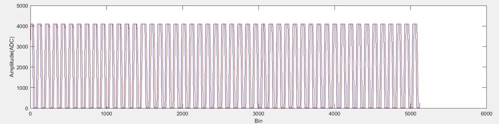

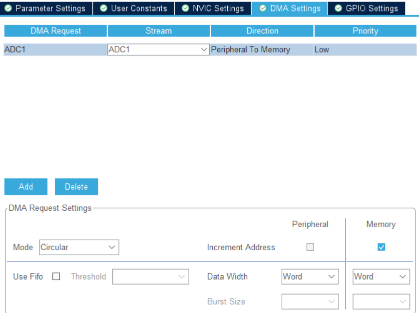

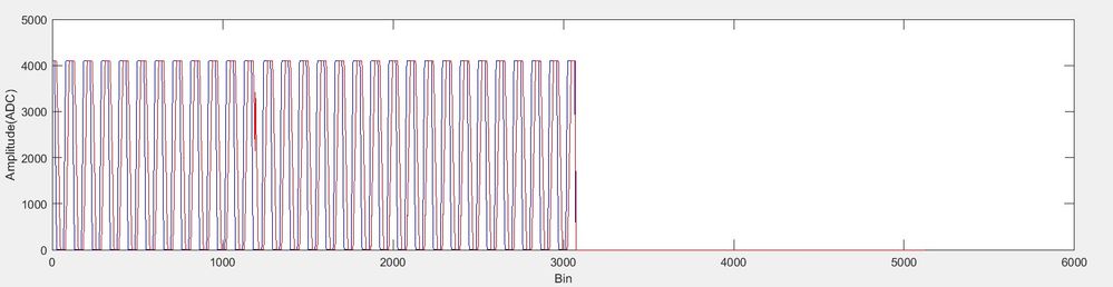

I am reading the data after sampling 2048 each 3 times.
But is there a reason why sometimes the data is read as 0?
The cube mx configuration and part of the code are as follows.
0693W00000Y8TlcQAF.png0693W00000Y8Tm6QAF.png0693W00000Y8TlwQAF.png0693W00000Y8TmLQAV.png0693W00000Y8TmkQAF.png
please help thank you
