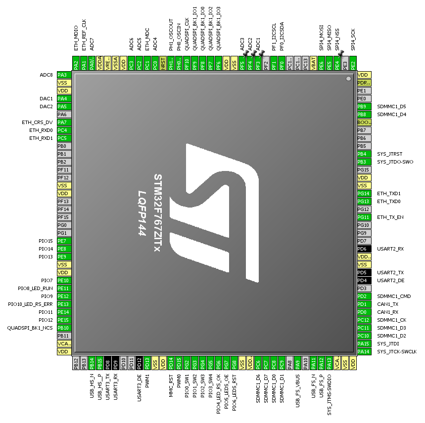

Provide pin usage on your board for the SDMMC interface, a USART usable for debug/diagnostic output and HSE clock source details, and I'll make a benchmark/integrity demo. sourcer32@gmail.com
Jack3
Senior III
Hi Clive,
thank you very much!
These are the pin connections (I hope this is what you mean):
STM32F767ZITx
PC8  SDMMC1_D0
PC9  SDMMC1_D1
PC10 SDMMC1_D2
PC11 SDMMC1_D3
PB8  SDMMC1_D4
PB9  SDMMC1_D5
PC6  SDMMC1_D6
PC7  SDMMC1_D7
PD2  SDMMC1_CMD
PC12 SDMMC1_CK

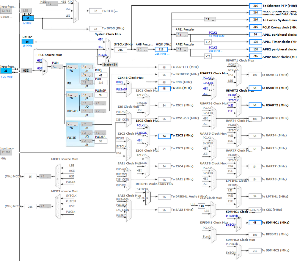

PLL48CLK (48MHz) to MMC
void SystemClock_Config(void)
  RCC_OscInitTypeDef RCC_OscInitStruct;
  RCC_ClkInitTypeDef RCC_ClkInitStruct;
  RCC_PeriphCLKInitTypeDef PeriphClkInitStruct;
    /**Configure the main internal regulator output voltage
  __HAL_RCC_PWR_CLK_ENABLE();
  __HAL_PWR_VOLTAGESCALING_CONFIG(PWR_REGULATOR_VOLTAGE_SCALE1);
    /**Initializes the CPU, AHB and APB busses clocks
  RCC_OscInitStruct.OscillatorType = RCC_OSCILLATORTYPE_HSE;
  RCC_OscInitStruct.HSEState = RCC_HSE_ON;
  RCC_OscInitStruct.PLL.PLLSource = RCC_PLLSOURCE_HSE;
  RCC_OscInitStruct.PLL.PLLM = 25;
  RCC_OscInitStruct.PLL.PLLN = 432;
  RCC_OscInitStruct.PLL.PLLP = RCC_PLLP_DIV2;
  RCC_OscInitStruct.PLL.PLLQ = 9;
    _Error_Handler(__FILE__, __LINE__);
    /**Activate the Over-Drive mode
  if (HAL_PWREx_EnableOverDrive() != HAL_OK)
  RCC_ClkInitStruct.APB1CLKDivider = RCC_HCLK_DIV4;
  RCC_ClkInitStruct.APB2CLKDivider = RCC_HCLK_DIV2;
  if (HAL_RCC_ClockConfig(&RCC_ClkInitStruct, FLASH_LATENCY_7) != HAL_OK)
  PeriphClkInitStruct.PeriphClockSelection = RCC_PERIPHCLK_USART2|RCC_PERIPHCLK_USART3
                              |RCC_PERIPHCLK_I2C2|RCC_PERIPHCLK_SDMMC1
                              |RCC_PERIPHCLK_CLK48;
  PeriphClkInitStruct.Usart2ClockSelection = RCC_USART2CLKSOURCE_PCLK1;
  PeriphClkInitStruct.Usart3ClockSelection = RCC_USART3CLKSOURCE_PCLK1;
  PeriphClkInitStruct.I2c2ClockSelection = RCC_I2C2CLKSOURCE_PCLK1;
  PeriphClkInitStruct.Clk48ClockSelection = RCC_CLK48SOURCE_PLL;
  PeriphClkInitStruct.Sdmmc1ClockSelection = RCC_SDMMC1CLKSOURCE_CLK48;
  if (HAL_RCCEx_PeriphCLKConfig(&PeriphClkInitStruct) != HAL_OK)
    /**Configure the Systick interrupt time
  HAL_SYSTICK_Config(HAL_RCC_GetHCLKFreq()/1000);
  HAL_SYSTICK_CLKSourceConfig(SYSTICK_CLKSOURCE_HCLK);
  /* SysTick_IRQn interrupt configuration */
  HAL_NVIC_SetPriority(SysTick_IRQn, 0, 0);

USART2 on PA2/PA3?
Jack3
Senior III
Hi Clive, USART 2 is on PD5 (TX) and PD6 (RX). Thanks, Jack.
