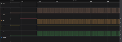

Was hoping that I could generate code using the motor control workbench/cubemx and then reverse engineer it from there but thats proving to be an absolute nightmare !!! I gave up ...
The datasheet says "DIAG-EN LOW logic level switches OFF all power MOSFETs"
But it does not specify exactly how ENx is to be used.
Maybe we need some prior knowledge of motor control applications and DMOS drivers to understand its usage, but I have no clue.
I was able to get the motor profiler application running to check if my setup is good and then,
I probed the ENx lines with a logic analyzer looks like they are normally low and then toggled once and held high once the application starts.
DIAG-EN seems to be driven identical to ENx for the most part except its not toggled always held high,
but you need to handle overcurrent and thermal protection through your circuit/code as per the datasheet.
